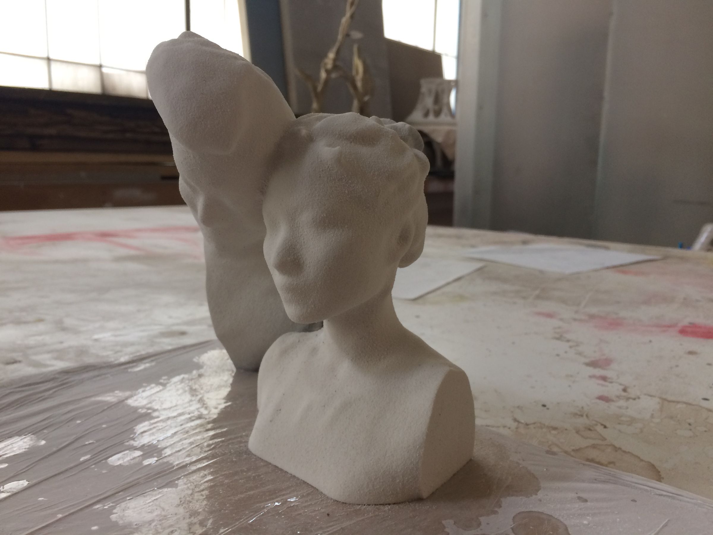

Step 2: 3D Printing (Formlabs 2)
Stereolithography (SLA) printing, a method where liquid resin is hardened by fine laser (UV) light. The printer I use here is Formlabs 2.
Select the material: Open PreForm, the native software for preparing 3D prints. Make sure the setting on your computer is the same as the material in the resin cartridge.
Prepare the file: Open the 3D file in PreForm software. Scale, reposition and build support structures. You can adjust the size of the print by calculating the print time.
Print: Send the file to printer and hit print on the machine.
Post processing: Take the print out of the printer and go through an isopropyl alcohol (IPA) bath and baked with UV light.
