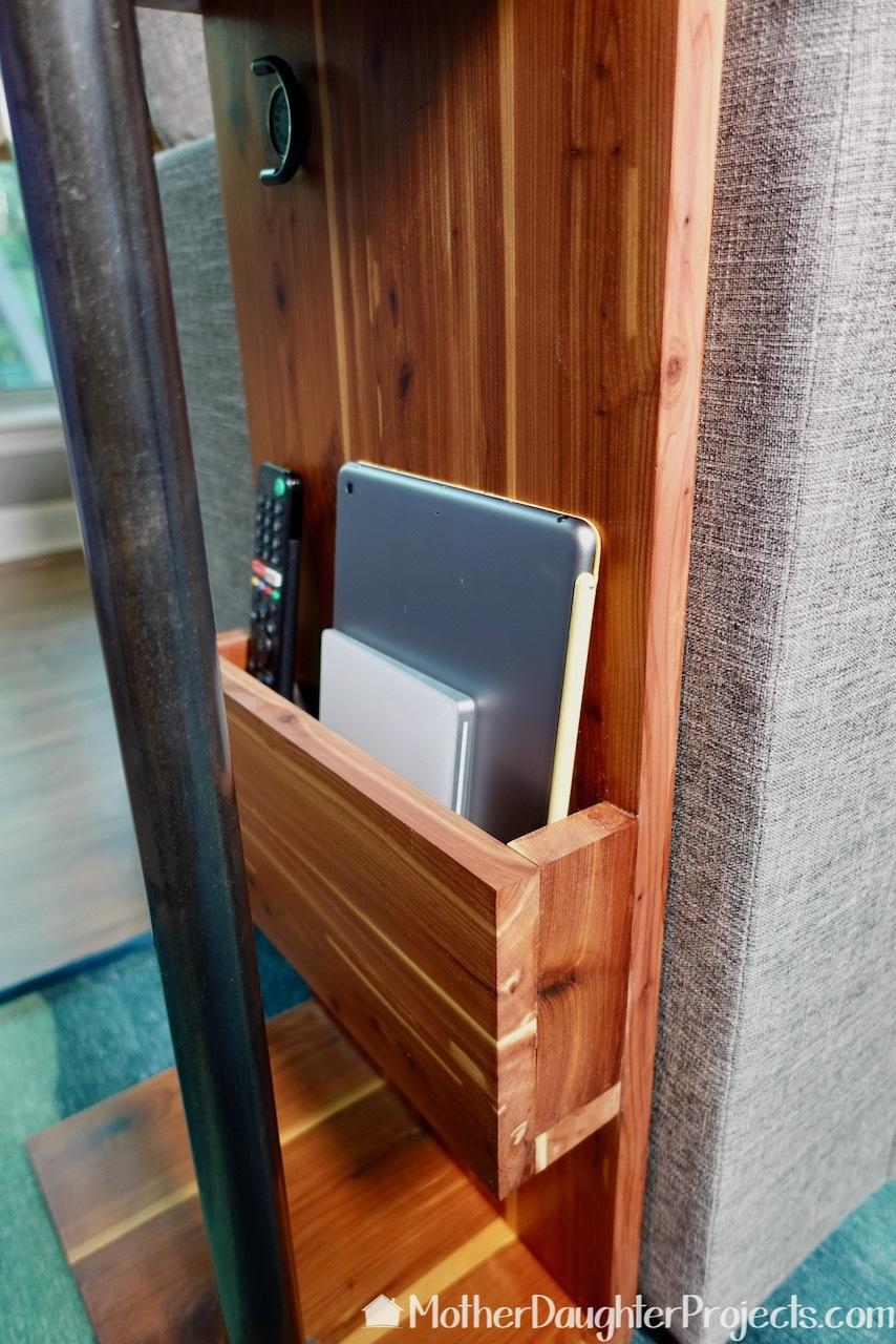

Time to assemble. We used wood glue to assemble as well as clamps to hold everything while it dried. At this point, the pipe and flanges are not attached but are in place just to hold everything at the right distance.
The pocket is glued into place six inches from the bottom of the table. Steph added a few brad nails to hold the pocket in place while the glue dried.
The entire outside of the table gets a coat of wax and then buffed with 0000 steel wool for a beautiful matte finish.
Lastly, the pipe is screwed into place. You'll notice it is off-center which is by design to make it easier to utilize the tech pocket.
Step 4: Add Tech and Pop Socket
All the tech is now easy to reach and there is also a convenient place for a phone with the attached Pop Socket holder.
