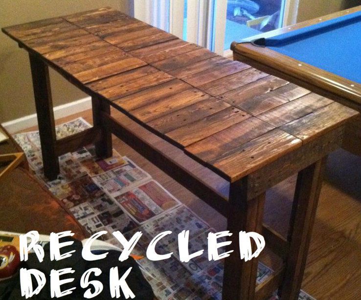

I was in need of a dresser after moving, so I designed this four drawer dresser, Skinned in pallet wood, to match with the desk I built (previous Instructable). Or
