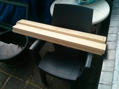

For this step I cheated a little bit. I knew I wanted this table to look really nice, and that meant I needed my boards to be as straight as possible with an even thickness throughout. I knew I wasn't going to succeed in that by just using hand planers, so I went to a local workshop that had access to a jointer and planer, and asked them if they could prepare the boards for me. Normally, this is something they wouldn't do, but they liked the idea, so they made an exception. The boards came back beautifully cleaned. I don't recall ever having boards this clean to work with!

Since I wanted the boards to be as tidy and as neatly done as possible AND I wanted to use dowels to reinforce the final slab, I needed a better jig. The previous one didn't work out as well as I'd hoped, so I made new ones. Maybe I'll do a mini instructables on those jigs later. The original jig was based on a youtube video I found here. I made my version with a bit of overhang so I could flip it around and I made the body too thick, which meant I couldn't properly drill through the jig.
I also found during my last project with the boxes that if you use the same side of the jig all the time, there's a bigger chance for the holes you drill to be slightly misaligned. I rememedied this by making a jig with a smaller body and shorter arms. I would clamp the boards together and mark where the holes needed to be for the dowels. Then I would put the jig on the first board and drill, then for the second board, I would flip the drill around and drill from the other side. This way, even if the angles were a bit off, at least the angles of the holes matched each other. This worked quite well.
For this project, I spent money on tools (clamps) and the only other money I spend was on the rods I would cut dowels from. It was much cheaper to just buy a few rods and cut them at lengths of 4 cm. I then took a file and ground the top of each dowel down a bit to make it easier to fit them into the holes... This whole process, from creating the jigs to filing down individual jigs took quite some time.
After the jigs were done connecting, gluing and clamping the boards was easy and straightforward. I had 6 boards total, so made 3 sets of 2, clamped and glued, waited for the glue to dry, then connected the set. When all 6 boards were connected I sanded the whole thing down and had an awesome looking slab.

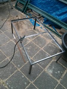

To start with I took some metal profiles I scavenged off some old metal pallets and started to clean off the rust on them.
To fit the frame as closely around the table top as possible, I cut the pieces I was going to use and clamped them as closely around the table top as I could. I started on one end, touch welded that, and worked my way, measured, cut and touch welded at the other sides as well.
This is where the painter's tape had another benefit: I prevented (too deep) burns on the wood. It was difficult to strike a balance between touch welding the sides together strong enough to hold, and too strong to A: burn the wood and B: warp the metal. These profiles were thin, and it was tricky to get the amperage right with using the thinnest electrodes I had. By that I mean: getting in that fine spot where the electrode doesn't stick to the material, or burn straight through the material.
Step 5: Welding the Rest of the Frame
After the frame had been touch welded all around the table top, I took the top out and did a full weld around the frame. This was tricky because it was easy to burn through the metal profiles. I ended up burning several holes, then drip feeding material back in to close them (=play with your melting bath and add one drop at a time). When a hole was filled up plenty, I ground off the excess beads. Luckily the drip feeding didn't appear to seal in any slag.
Then I took corner magnets (another thing I purchased for projects like these a while ago... another hidden cost) and measured down and welded on the legs. They needed to be equal in length, and completely at a 90° angle. To prevent accidentally welding in the magnets, you remove them as soon as the feet are attached. But during the welding of the first leg, the heat warped the metal, so I had to cut it off and reattach it at the right angle again.
I added in supports at the feet to the profiles had a big of surface to them and wouldn't cut into the floor. I did this by first welding on a piece of leftover scrap at a 90° with the magnets, then cut them off and shape them with a grinder.
Initially I wanted to put adjustable feet in there for uneven floors. So I had to drill holes in the feet and thread them. But because the metal was thin there was no room for a thread through it. So I cut off another piece of scrap metal and welded a tiny piece in each feet to make it thick enough. Unfortunately, eventually I couldn't drill all the way through this, so the adjustable feet will not be on this table... maybe on another project.
When all this was done I ground everything down nice and smooth, and put a coat of paint on it. Don't know the kind, the cheapest one I can find in whatever sale or flee market. I choose black over transparent.
