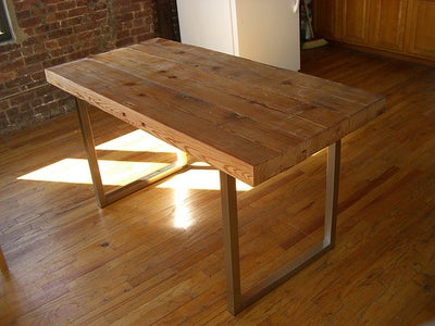

After using a cheap plastic card table as my only table for nearly two years I decided it was time for a change. I had seen some large wooden tables that I liked and figured that I could make one myself. I also used reclaimed wood to make this table so it's a bit cooler looking (and environmentally friendly!).
The finished product is heavy, but not too bad. I'm using Douglas Fir which is a bit soft. Marks will show on the table, but to me that is okay. You may want to adjust your wood choice if you like something different.

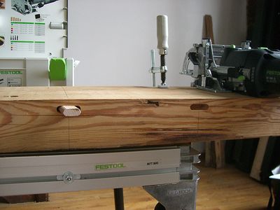

I used my Domino to cut mortises in the pieces and then glued them together with tenons in place. There are 28 mortises in the table. I imagine you could get by with less, but I was a little nervous about this falling apart.
Step 4: Sand the Surfaces, Attach Legs
I sanded the surfaces to make sure they were smooth and splinter free. I started with 60 grit and then went up all the way to 220 to make sure it was very smooth. This makes a huge difference so I think it's worth spending some time on.
The legs are from Ikea. I think they are for expanding a countertop. We've been using them at my work to build desks for people so I figured they would be great for this too. They cost about $30 each so not too bad. I like the contrast of the metal to the natural wood.

    Nice appearance but some alternatives to the Domino for the majority of viewers would have been nice as most folks can't afford Festool. Dowels, biscuits, or even a well racked group of clamps and Titebond III will align and hold just fine. The Arm-R-Seal is an excellent choice for fir, heart pine, or virtually any hardwood but 3-5 coats on a porous species of wood will build depth, aid in cleaning, and help (somewhat) toughen the top from denting and scratching. It also "pops" the grain and enhances the color of vintage wood. Nice clean look table

    @Lukulele: assuming the different sections are accurately planed at right-angles, would glueing be good enough?
