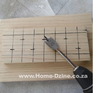

- I marked off the length of the board in 35mm sections with a 20mm border along the long edges. The back row allows for 4 eggs and the front row for 3 eggs. You can increase the length to store more eggs.Draw a line down the centre of the board and then measure 15mm on either side on alternative rows to make the positions for drilling holes with a 25mm spade bit.

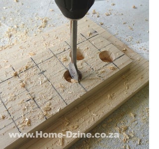

- Place a scrap board underneath the board you will be drilling. This reduces the amount of chipping off on the underside and also makes it easier to work.Place the tip of the spade bit on your marks and drill out the holes.Clamp the board to your worktop as you drill to prevent it from spinning.

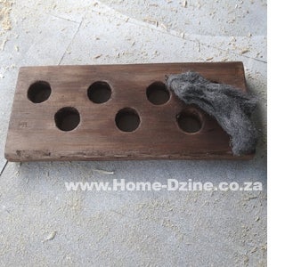

- Use a rag to apply one even coat of Woodoc gel stain to the top, sides and base of the pine.
You will also need to wrap the rag around your finger to apply stain to the cut out holes. - Use steel wool to distress if you want the pine to look aged and even more rustic.
Lightly rub the steel wool over the surface, working with the grain. - Use Pattex repair gel or Gorilla glue to stick your handles onto the base of the egg holder.
