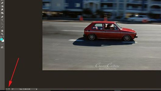

Since some images may be too small or large, you may need to adjust the images size. In order to do this, double-click the image percentage at the bottom left hand corner of Photoshop. Using the digits on your keyboard you can Increase or decrease image percentage to your liking. It is recommended you make the image large enough so you can see the smallest details.
Step 1: Import Image
In order to complete any Photoshop project, an image must be selected for editing. To do this, select the File option in the top left hand corner of Photoshop. From there, select the Open option, and double-click the image you desire to edit.

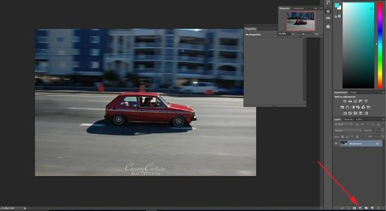

Step 2: Select the Adjustment Layers Icon
Once the desired image is selected and sized appropriately, the recoloring process can begin. Begin this process by adding a new layer. To do this, select the fourth icon in the properties tab, which is located at the bottom right hand corner of Photoshop.

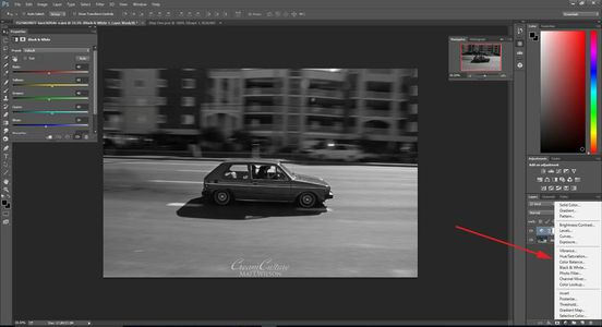

Step 3: Add Desired Layer Effects
After selecting the layers icon, a variety of options will appear. For this process, we will add two layers: Black and White and Hue/Saturation. The Black and White option will add a Black and White layer of your image, but will not alter the original image. The Hue/Saturation option will allow you to adjust the lightness, hue, and saturation of the image (via slider bars) to your liking without altering the original image. In order to achieve your desired lightness, hue, and saturation, experimenting with each slider bar may be necessary.

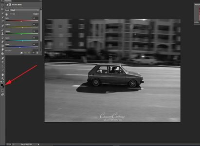

Step 5: Chnage Fill Color
After selecting the quick selection tool, we must change the fill color to black. This a vital part of the process, as it will allow us to return the subject to the original color of the image. To do this, select the fill box at the bottom of the vertical toolbar. The fill box icon contains two rectangles overlapping each other. Select the uppermost rectangle and change the fill to black.

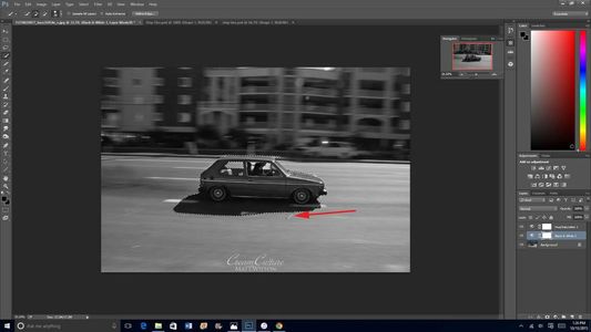

Step 6: Recolor the Image's Subject

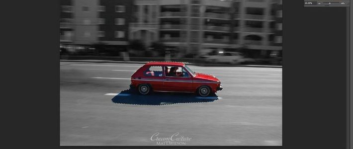

Once the proper fill is selected, it is time to recolor the subject of the image. To begin this process, click on the subject you wish to colorize (in this case the car) with the quick selection tool.It may be necessary to click multiple portions of the image before the quick selection tool selects the desired subject completely. When this is done, the subject of the image will become outlined in a dotted line.
Step 7: Undo Quick Selection Mistakes
If you accidentally select an unwanted portion of the image with the quick selection tool, there is a quick fix available. Simply click Ctrl+Z on Windows or Command+Z on a Mac to undo the unwanted section.
Step 8: Remove Adjustment Layer From the Image's Subject
After outing the subject of the image, we must bring the original color back to the subject. To achieve this, simply click alt+backspace on Windows or option+delete on a Mac to remove the layer of Black and White within the dotted outline. Doing so will retrieve the original color of the outlined subject

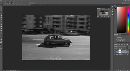

Step 9: Finished Product
Upon completion of step seven, the image will have reached the desired outcome. Now, you have a black and white image with a recolored subject to do with as you please!
