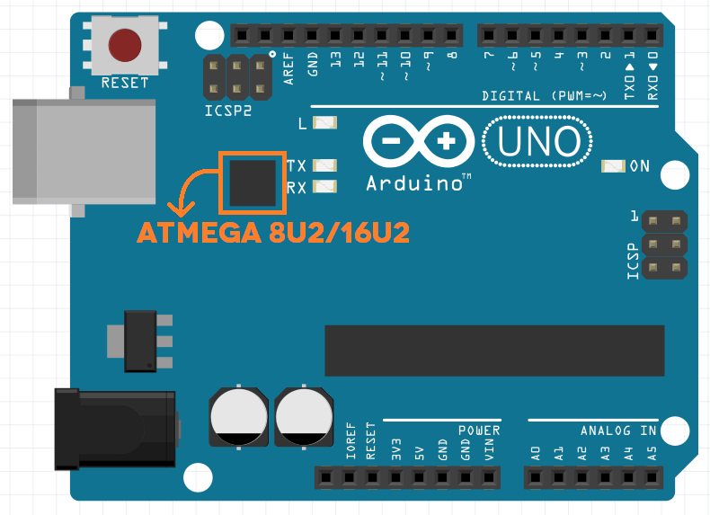

HIDUINO is a firmware (code) made to run on the microcontrollers Atmega8u2 (Arduino UNO Rev 2 -and previous- or Mega2560) and Atmega16u2 (Arduino UNO Rev3).
These are the ones in charge of getting the computer and the boards to talk to each other. When the normal firmware runs on them (usbserial), we are allowed to upload sketches to modify the behaviour of the board, read inputs, write outputs and send messages via Serial ports, through the USB ports of the computer.
HIDUINO replaces this firmware, and allows the board to be presented as a Human Interface Device or HID. These kind of devices are very common, and we use lots of them everyday, such as keyboards, mouses, tactile screens, webcams, joysticks, ecc. What's nice about them is that usually we don't need any specialized drivers, since they are Plug&Play.
So far, the HIDUINO project has developed the code for the board to be recognized as an USB-MIDI device.

Now, I present the steps to flash the HIDUINO firmware to the Arduino UNO (microcontrollers Atmega8u2/16u2) or Arduino Mega (Mega2560).
Once flashed, you will loose the possibility to load any more sketches with the Arduino IDE through the normal USB port. To do this, you must reflash the microcontroller with its original firmware (usbserial).
However, it is possible to flash the main microcontroller (the long one, further from the usb port) with the Arduino IDE and an ISP programmer (or another Arduino), selecting the right programmer "Tools -> Programmer" and then "File-> Upload using programmer" ("Program-> Upload using programmer" from IDE 1.6.5). To do this, the programmer must be connected to the ICSP port next to the long microcontroller.
In any case, make sure to upload your final sketch to the board, before flashing HIDUINO.
