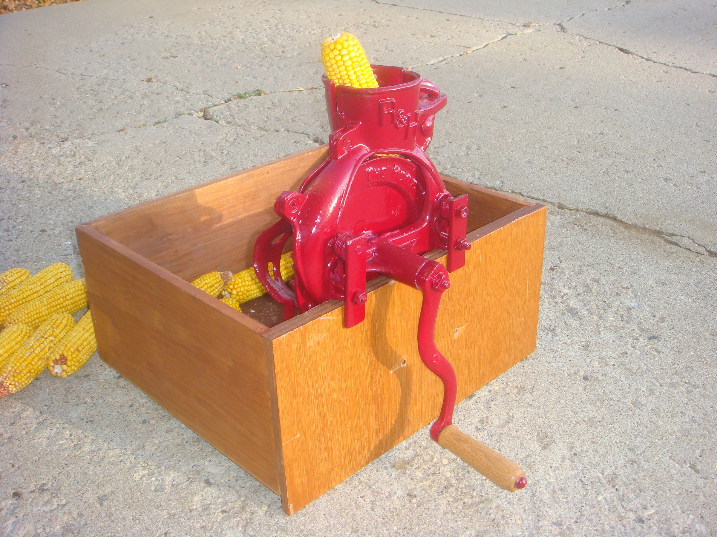

Step 1: Corn Sheller As Received
When purchased the sheller was operational except for the plate which applies pressure to keep the corn cob in contact with the cast iron wheel that removes the kernels. The wood crank handle and fan belt were missing.

Lower half of sheller was assembled and then the cast gears and sheller parts inserted. After the top half was assembled the galvanized metal was masked and the bolt heads and nuts were painted orange.
The last four photos show the finished reconditioned corn sheller.
