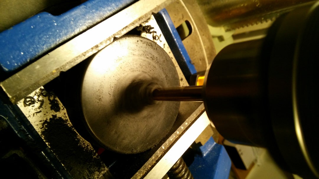

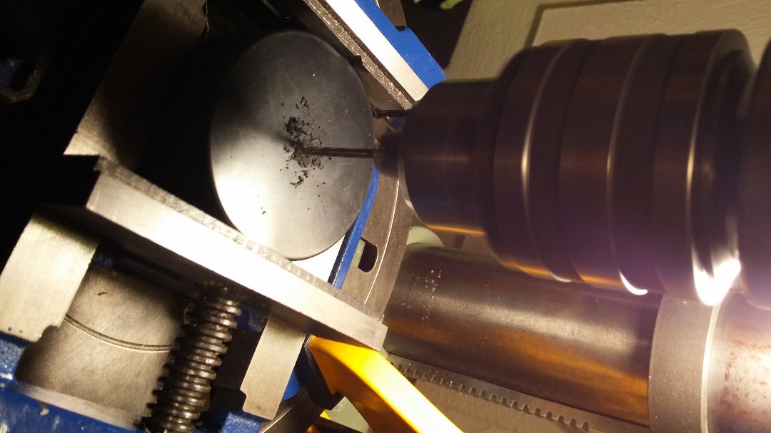

Step 3: Drill
Drill the center through with a small drill bit and redrill the hole with larger bits until the hole accommodates the spindle on your turntable.
