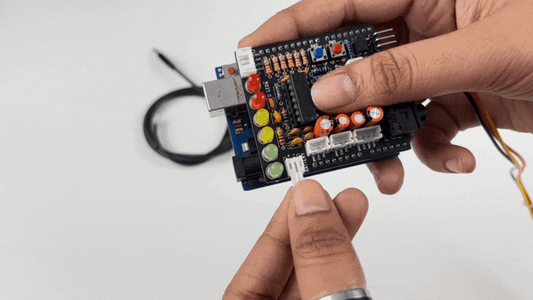

Step 1: Assembly
First of all, you have to assemble all the passive components on the Muscle BioAmp Shield PCB. For a step-by-step guide for the assembly, you can follow the video above or take a look at this interactive BOM.
Step 2: Stacking on Arduino Uno
Stack the Muscle BioAmp Shield on top of Arduino Uno properly.

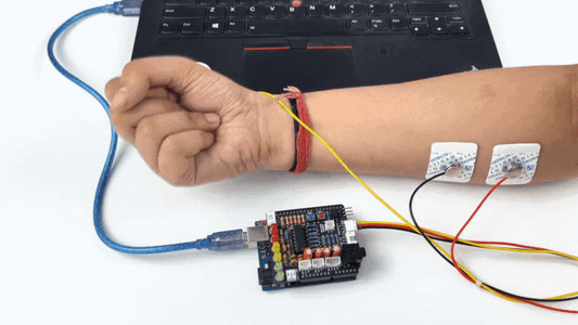

Step 3: Connecting Electrode Cable
Connect the BioAmp Cable to Muscle BioAmp Shield as shown in the connection diagram.
Note: Don't place the electrodes on the skin at this moment.

Step 5: Electrode Placements
We have 2 options to measure the EMG signals, either using the gel electrodes or using dry electrode based EMG band. You can try both of them one by one.
Measuring EMG using Gel electrodes:
- Connect the BioAmp Cable to gel electrodes,
- Peel the plastic backing from electrodes
- Place the IN+ and IN- cables on the arm near the ulnar nerve & REF (reference) at the back of your hand.
Measuring EMG using Muscle BioAmp Band, a dry electrode based EMG band:
- Connect the BioAmp Cable to Muscle BioAmp Band in a way such that IN+ and IN- are placed on the arm near the ulnar nerve & REF (reference) on the far side of the band.
- Now put a small drop of electrode gel between the skin and metallic part of BioAmp Cable to get the best results.

Step 8: Enjoy & Flex Your Arm
Now flex your arm to visualize the muscle signals (EMG) in real time on your laptop (on serial plotter of Arduino IDE) as well as on the onboard LEDs of Muscle BioAmp Shield.
More strength you apply, more the LED bar goes up.
Similarly you can try to record EMG from other parts of your body like biceps, triceps, cheeks, thighs, etc.
Step 9: Listen to Your Muscles
Here comes the most interesting part of the project which is listening to your muscles.
You can either listen it on a speaker or wired earphones/headphones. Let's try both of them.
Listening on a wired earphones/headphones:
- Plug your wired earphones or headphones on the 3.5mm jack of Muscle BioAmp Shield
- Plug it in your ears
- Flex and listen to your muscles
Listening on a speaker using BioAmp AUX Cable:
- Plug the BioAmp AUX Cable on Muscle BioAmp Shield
- Connect the BioAmp AUX cable on the speaker
- Flex and listen to your muscles.
