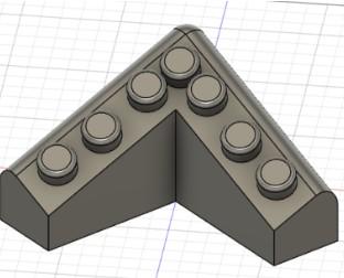

Step 4: Fusion 360 Designs of First Prototype
Design Requirements:
- It must be able to fit on a try
- It must be safe for Garek to use
- It must be stable enough to support the 3 goose necks
After determining the requirements for the AAC device, a Computer Aided Design (CAD) of the parts we will need to cut out of the Medium Density Fireboard (MDF) board. Here we have the Fusion 360 designs of the base box and the mount for the buttons. We went through several redesigns to finally reach this point.

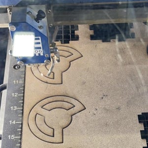

Step 5: Constructing of Base
After we had the design in Fusion 360, we converted the files to DXF. We opened the files in Inkscape to adjust the canvas size, rearrange the pieces, and adjust the stroke for laser cutting. Then, we saved the file as a PDF. We used the Epilog Fusion Laser Cutter to cut our designs out of a wood panel. Before printing, we made sure our canvas size was correct, and changed the vector setting to 1% speed, 100% power and 50% frequency. Furthermore, we had to readjust the job and focus of the machine and also turn on two vacuums. Due to the type of panel we currently used, each piece needed two passes for the laser to cut all the through.
