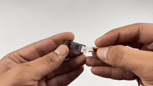

Step 3: Connecting Electrode Cable
Connect the BioAmp Cable to BioAmp EXG Pill. We have different variants of the BioAmp Cable so don't go with the color coding and focus on the REF, IN+ and IN- written on the BioAmp EXG Pill.
