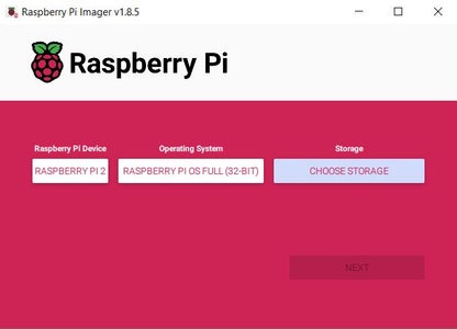

Step 1:
The strategy was first to create a new micro sd card using the Raspberry Pi Imager and installing image with no desktop environment and selecting the Bookworm Operating System version.
Start the raspberry pi 2B with the micro sd and the USB Sata SSD also connect.

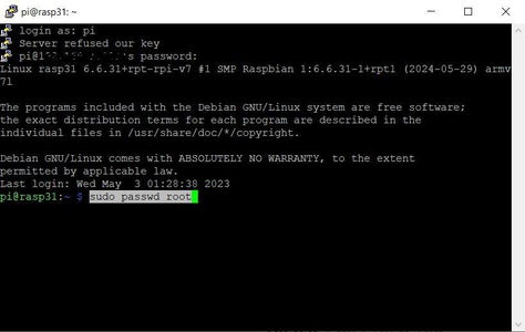

Step 2:
Provided a password to the root using the command sudo passwd root and update the password to be more easy to work. Then use the command su and provide the previous password.

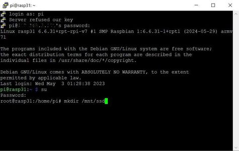

Step 3:
Create a mount point mkdir /mnt/ssd, it is possible to get the structure partition using the command lsblk, the partition that need to be used is the sda2 in my case but is need to validate for each case.

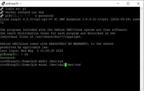

Step 4:
Mount the SSD on the mount point create with the following command mount /dev/sda2 /mnt/ssd.

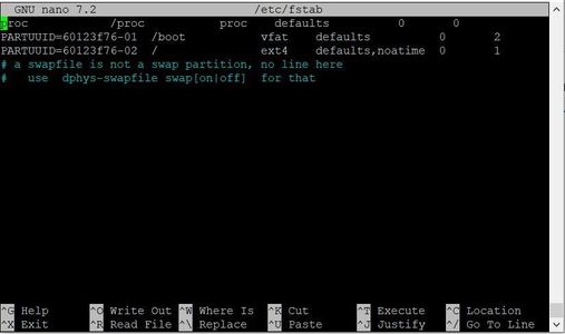

Step 5:
With the access to the USB sata SSD is possible to update the using the nano nano /mnt/ssd/etc/fstab, I have used the same value from the for the PARTUUID from Working Procedure to Make Raspberry Pi 2b V1.1 Boot From Usb Sata SSD.
The example is below that is on the file fstab:
proc /proc proc defaults 0 0
PARTUUID=60123f76-01 /boot vfat defaults 0 2
PARTUUID=60123f76-02 / ext4 defaults,noatime 0 1

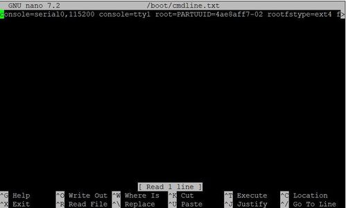

Step 7:
Update the nano /boot/cmdline.txt or nano /boot/firmware/cmdline.txt but I also update the nano /etc/fstab with the same PARTUUID=60123f76.
Applying all the changes I was able to boot again the USB sata SSD, without lose any data.

Also update on SSD nano /mnt/ssd/boot/cmdline.txt or nano /mnt/ssd/firmware/boot/cmdline.txt the PARTUUID=60123f76.
It the file cmdline.txt on the firmware folder do not exist, copy the line from the microsd card file cmdline.txt and paste it.
The update nano /mnt/ssd/etc/fstab the PARTUUID=60123f76.
This final step will allow when boot the ssd have the correct partition in case exist a difference.
