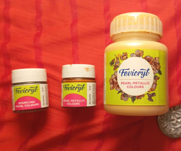

  1. Fevi-Cryll ( Skin friendly and easy to use clay )
  2. Acrylic Colors
  3. Golden Color
  4. Copper Color
  5. Silver Color

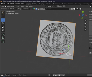

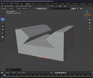

Then I started with the design of these models, for this, I have used the Fusion 360 Software and Blender softwares, you can use any CAD software of your choice. First I collected images of each coin, then converted those into SVG files using online converters. Then I imported the SVG files in Fusion 360 to sketch and extrude our designs.

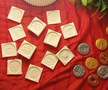

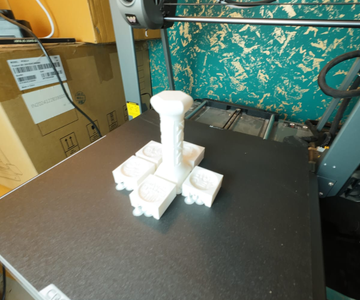

Step 3: 3D Printing Stamp Holder and Mods
Next I 3d Printed the stamps on my 3d printer and did some post processing to use the designs for making coins.

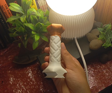

Step 4: Easily Swapable Design
I have also designed this stamp holder and replacement mechanism to easily replace different molds and easy coin making.

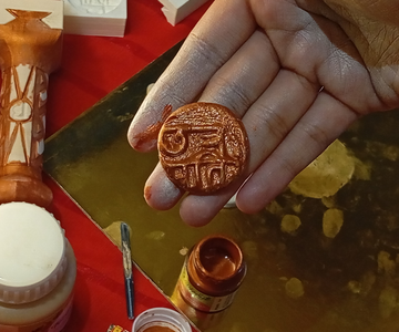

I used the stamp holder to print on the clay using different molds.
Step 7: Painting Time
Then I painted all the coins using acrylic colors

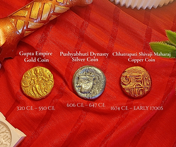

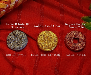

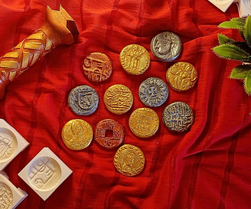

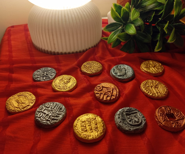

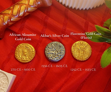

Step 9: And Here Are the Coins !
Finally here are the coins. Perfect for a collection of yours.
