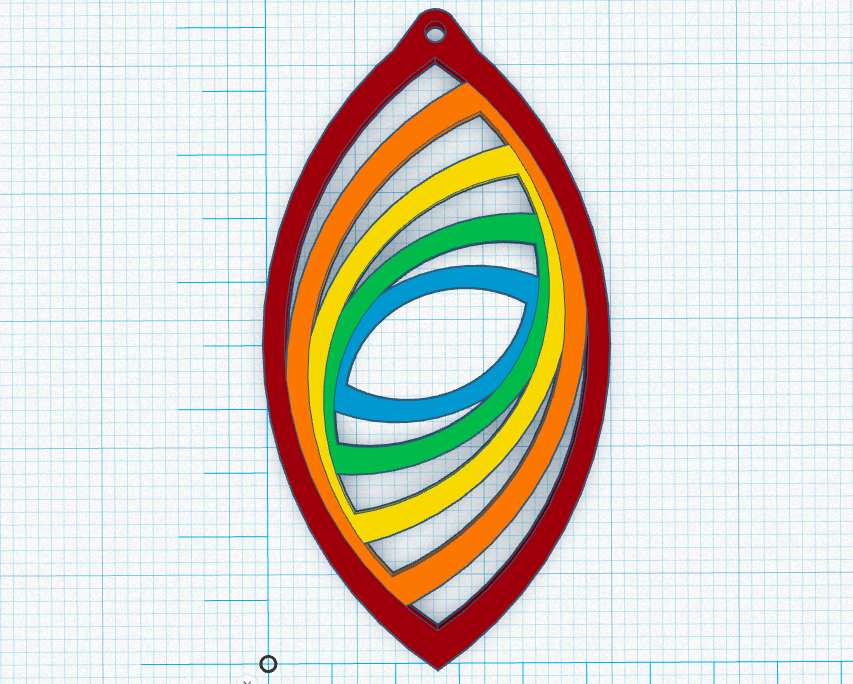

You need to figure out what shape you are going to start with; I decided to use an almond shape. A shape with some symmetry is desirable. I don't think it will work very well with a wonky shape.
Now, figure out what's the biggest you want it to be. Mine is about 50mm tall by 26.5mm wide.
We want the shape to be cut out so we'll do that now. I just eyeballed this.
Next we make it smaller and rotate it. To start, I wanted the thicknesses of all the shapes to be about the same. To do this you have to shrink the shape, then ungroup it, resize the cutout so it is the same difference in size as the big shape (for me this was roughly 3.11mm in the width direction, and then regroup them.
Otherwise, you can kind of eye ball this, but I shrank the shape to about 43 by 22.5 and rotated it about 11 degrees.
Now we're going to do this again, do it with the large shape as we don't want to distort the shape so we have to shrink it, and then rotate it.
I did this until I had a total of 5 shapes. I did a bunch of testing, undoing, and retesting to get these amounts, so just play around.
To get this right, I recommend figuring out the sizes first and then rotate them until you are happy with them. You can see mine fit out inside of each other.
As you can see below, I made them all just slightly smaller the the one before.
Here are the rough measurements for the size of each and how much they were rotated from their center position, but remember, I rotated it until I liked it and then I figured out the degrees for you.
  • Outside/1st Shape - 50mm by 26.5mm - start position
  • 2nd Shape - 43mm by 22.5mm - rotate 11 degrees from start position
  • 3rd Shape - 35mm by 18.6mm - rotate total of 26 degrees from start position
  • 4th Shape - 27.5mm by 14.6mm - rotate total of 45 degrees from start position
  • Center/5th Shape - 21mm by 10.8mm - rotate total of 66 degrees from start position
Below you an see how you can rotate them all together dropping one at a time until you get to the center and are happy with the spacing.
Add your hole! I kind of added more to the top to give me space for the hole but you can also just add a loop. I try to avoid loops since I don't really like them.

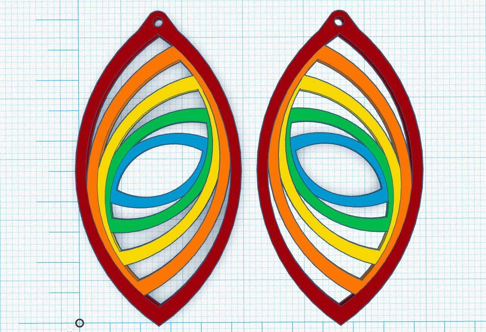

But once you have it all figured out you can copy it, and flip it so you have mirror images for the earrings.

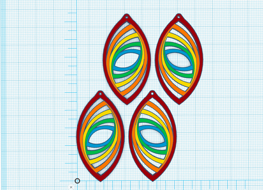

Each print is meant to be 1 half of 1 earring. And since I wanted a mirror pair I started by copying and mirroring my design.
How this is the front of each earring meaning I need two more of the same for the back.
In order to print these with the multimedia extruder, I lined this up how I wanted them and exported all the same color so I had 5 pieces. Though you can do these in any color combination. I've done 5 different colors and just 2 different colors too.
