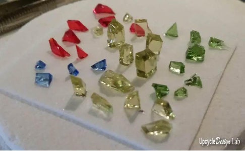

Step 3: Cut Glass
As I mentioned I am not very good at cutting glass. But the nice thing about fusing the glass is that most of those sharp edges melt into shiny smooth surfaces. There aren't too many rules to designing your glass piece. You do have to keep the pieces small to fit in the kiln properly and you want to be sure to use kiln paper under your glass to protect the kiln. Other than that you can fuse tiny pieces or stack pieces together to make new shapes. You can mix colors and as I mentioned before you can even make beads and fun imprinted shapes. I recommend doing a couple of tests so you get familiar with how the glass reacts when it is fused.

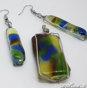

This picture shows the four steps from cut to finished jewelry. The earrings are on the top row and the pendant is on the bottom row.
1 - Cut pieces quantity and size
2 - Stacked pieces prepared for fusing
3 - Pieces after fusing
4 - Finished Jewelry Pieces

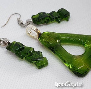

Step 5: Assembling Example 2 - Compound Round Shapes
This example shows small glass pieces arranged to make a circular shape.
Step 6: Assembling Example 3 - Triangle Shape
Here you can see how to build a triangular shape.

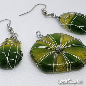

Step 7: Assembling Example 4 - Combining Colors
This example shows an example of mixing colors.

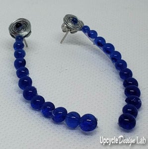

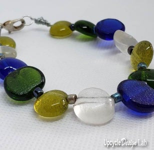

Step 8: Assembling Example 5 - Making Beads
As I mentioned you need to make sure to use the kiln paper under each piece before fusing to protect the kiln. But you can also do some fun things with the kiln paper as well.
To make fused glass beads I cut thin long strips of kiln paper and eight small square pieces of glass.
Before fusing the pieces are stacked with the kiln paper sandwiched in between the two layers of glass. For rounded beads make sure the corners of the squares or offset. For more square-shaped beads align the corners on the top and bottom piece of glass.
Once the pieces are fused the kiln paper is easy to remove and leaves a channel to string the glass together.

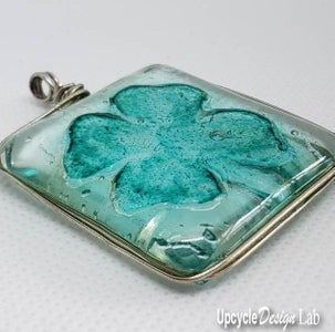

Another fun way to use the kiln paper is to make a pattern in the glass.
To do this just cut your desired shape out of the kiln paper. Then layer the glass on top. And fuse in the kiln.
