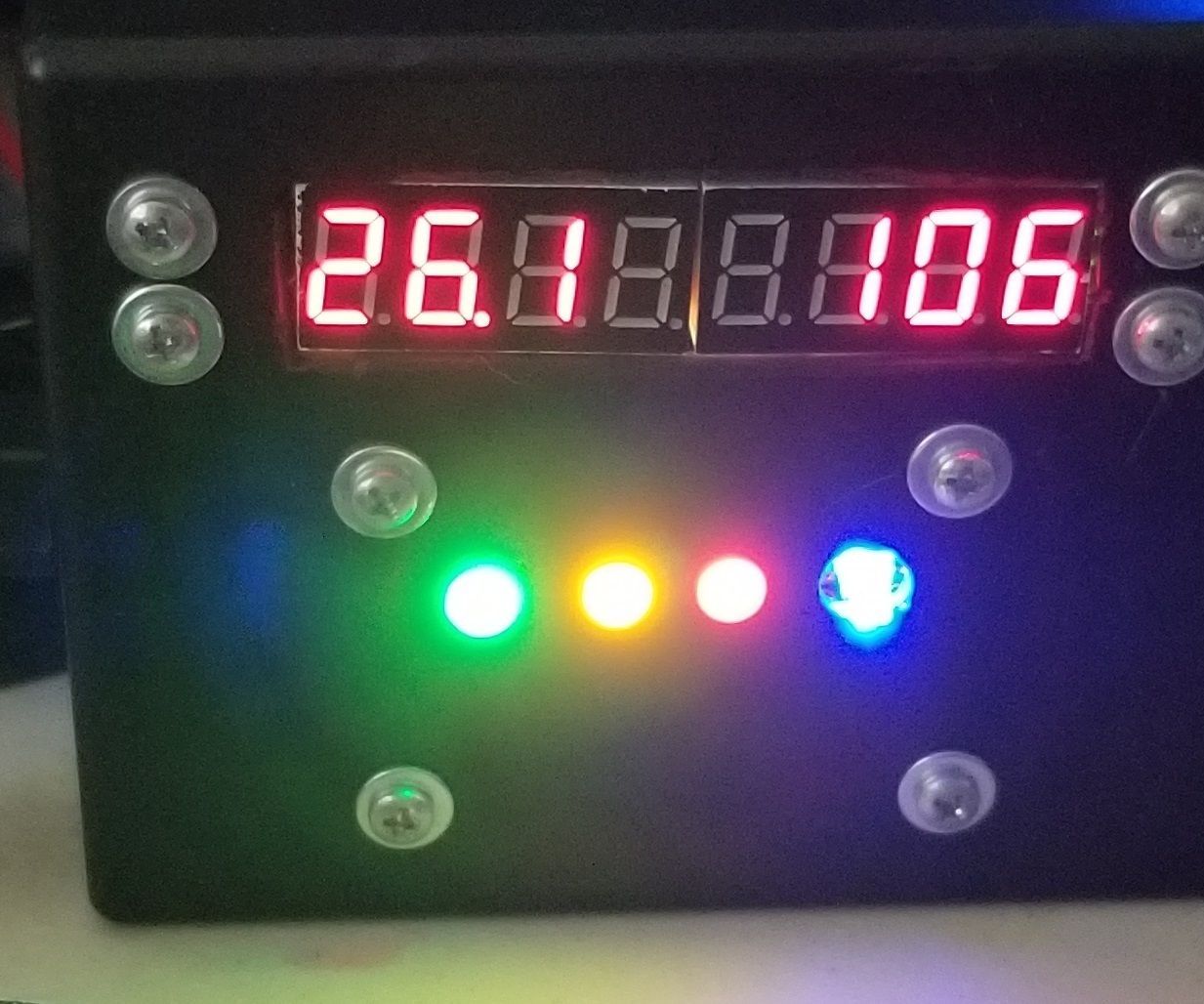

Time to play Tetris. First place the relay board to the far left with the wires facing toward the center of the case like what you see in the first 2 pictures of this step, not the second 2. You may need to use tweezers to reconnect the jumper wires from the Pi to the relay board.
Connect the ethernet and USB from the front of the case to the Pi. You will need to keep tucking wires under the case as you slide it back together. No need to use excessive force. If you find yourself in that situation, you may need to pull it apart and readjust whatever is blocking it and try again.
This is literally the hardest part. It took me a few hours to get it and it is hard to get more pictures while doing it. If you skipped some steps above and avoided adding ports to the font panel, this should take seconds to reassemble. You could also make this puzzle much easier by using the A+ model with a WiFi or ethernet dongle on its one USB port, but as I said above, WiFi will have massive singal loss if you do that. Even 802.11n will have trouble connecting thru the grounded metal of the casing. As I said eariler, I am still sticking with model B because of its ethernet and AV video ports.
Step 12: The Ultimate Test.
After getting the case back together, I tested it right away and it worked.
For safety reasons, I plugged into a GFCI outlet. This way, if there is a short circuit, it would trip the breaker only on the one outlet instead of the circuit breaker which will knock out several outlets in the house. Most houses and apartments today have them in the bathroom. Mine has one in each of my 2 bathrooms, one in my basement that is daisy chained to all the other outlets, 2 in my kitchen, and one in my garage.
If overheating is of concern for you, then connect to your Pi using SSH, or using your newly installed front panel ports and run the following command:
/opt/vc/bin/vcgencmd measure_temp
Again, I am not a Linux expert. I found this in the forums on the Raspberry Pi site. The output will show the temperature in celcius format. Its starting to get cold out so my heater is heating my house to 68ºF...Google translates that to 20.5ºC. My Pi measured 44.3ºC right after booting, and 44.4ºC after running for about a half hour. I activated all the relays (which increases power consumption on the Pi), left it that way for over an hour and its temperature rose up to 48.7ºC. I waited another half hour (still with the relays activated) and the temperature was 48.2ºC. Needless to say, the temperature ain't moving around very much. It is 80ºC where the Pi begins to overheat.
My powered items of choice were 4 guide lights I had lying around. These come in a 2 pack and I found them at Ace Hardware a few years ago. You can test your new device with any electronic, but I would suggest you start with the lowest power consuming item that you can possibly find before you move up. I don't know how much amperage it will take to burn out a relay, but I don't plan to try and find out. The relays on my board are stamped on them that they are rated up to 10 amps, but I will try to avoid going over 5 amps per outlet.
Now looking at the first picture in this step, I realize that the case has numbers 1-4 stamped and the web interface has 0-3 on my phone...the fact that I made this work with a Pi, I am celebrating too much to even care about that. Just rename the image files and that will easily solve that little confusion.
This project was a total success for me and I hope it will be for you too. Now to find out what to build next........
