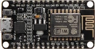

  3. An ESP8266 board (like NodeMCU or Wemos D1 Mini)

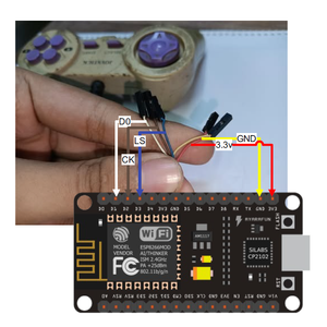

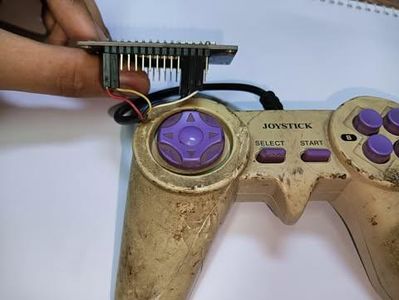

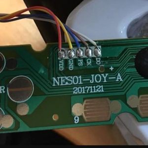

Step 4: Circuit Diagram – Connect ESP8266

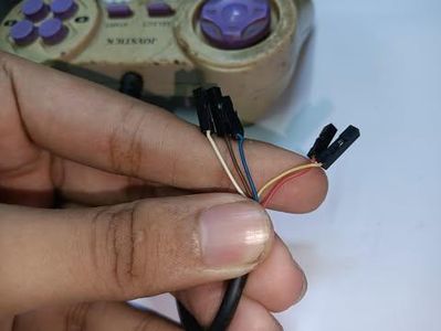

Remember this Color Code of any Clone NES Controller all are same
