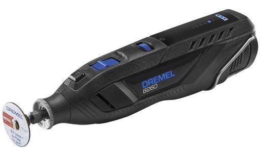

  • ROTARY TOOL

  • Cut the coconut as shown above using the Rotary tool such that the bottom portion has more length.
