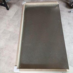

Step 10: Installing the Heat-Resistant Work Surface
Before the RecycleHub is ready for use, install the heat-resistant work surface. This top layer protects the workstation during tasks such as handling hot molds or freshly formed plastic parts.
Use a stainless steel sheet sized 764 by 432 mm. Position it carefully on the top panel so it sits flush and centered. Depending on your preference, fix it in place using screws in the corners, double-sided heat-resistant adhesive tape, or leave it removable for cleaning or replacement.
Once mounted, the stainless steel surface adds both durability and functionality, making the RecycleHub ready for intensive, hands-on recycling work.
