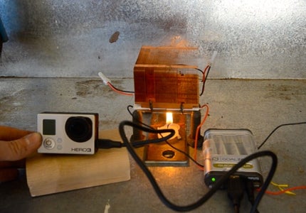

We have been working on creating a stable way to charge our electronics while camping for a while. Solar panels work alright, but I find that when you really need your cell phone and GPS it is dark, sinister, and stormy out.
This Thermoelectric Generator can produce energy from common temperature differences such as snow, tail pipes, engines, candles, wood stoves, campfires, and anywhere else there is a temperature difference.

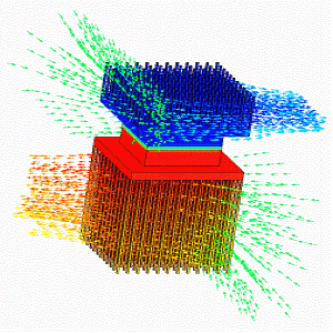

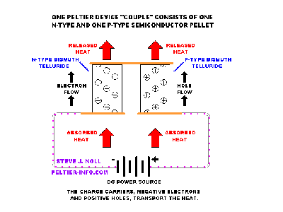

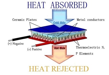

Peltier plates "pump energy" because of thermal and electrical continuity differences in the materials they are produced from. At first glance, many people wonder if conductors may work better than the semiconductors, this is where the major predicament of the Seebeck effect falls. If a material has a low electrical resistance, it also usually has a low thermal resistance. If a material easily allows heat to pass directly through it, then it will disperse the temperature gradient the Peltier plates require to function.
Inside of the Peltier plates are many pairs semiconductors, the two semiconductors are placed thermally parallel (but electrically in series). The two semi-conductors (usually referred to as "P" and "N") have different electron densities (the measure of the probability of an electron being in a certain position, higher the density, the more electrons and the higher chance of hitting one), this difference causes electrons in the P semi-conductors to flow along with the heat, while allowing the electrons to flow against it in the N. This creates an electrical current as the heat flows through the Peltier.
Peltier plates are also able to force heat to move a certain direction, if an electrical current is applied in one direction it will flow through the semi-conductors pulling the heat in the direction of the current in the P semiconductor and against the flow of the heat in the N. If the current is reversed the heat pump will reverse as well, the heat will always flow in the direction of the current in the P semiconductor.

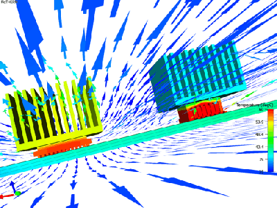

Because of the properties of Peltier plates they will hit a "wall." The plates can only disperse a certain volume of heat flux. To increase this volume there are multiple Peltiers in this generator are they are wired in series, this allows the plates to consume any excess energy passed on from the voltage regulator to pump heat. This increases the total heat flux volume of the generator.
We chose to use copper for our plate and heat sink because of its high electron density, meaning that it has an extremely high thermal transfer, allowing for energy production at very low thermal differences. This is why our generator can generate power from melting snow and solar rays, when ones with aluminum heat sinks are unable to. The animated heat sinks above show a simulated comparison of a copper and aluminum heat sink of the exact same dimensions, observe how the plate is cooler under the copper heat sink (on left) than the aluminum one (on right). Copper also has a higher melting temperature than aluminum, reducing the risk of accidentally melting our generator.

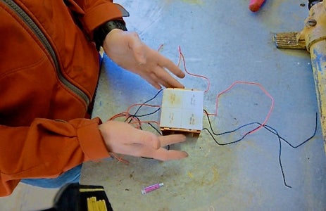

Step 5: Assembling the Generator

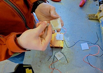

Part 1 - Before you can mount your Peltier (Seebeck) plates you will need to wipe them off with a damp cloth to remove any dust or debris to ensure a good bond with the thermal paste.
Part 2 - Apply a thin layer of thermal paste to each plate and place them onto the heat sink using an angled motion (to prevent air bubbles). Ensure that the plates are evenly spaced and make good contact.
NOTE: Both too little and too much thermal paste will inhibit heat transfer, make sure your coating is thin and even.
Part 3 - Apply a thin layer of thermal paste to the copper plate and place it top of the Peltier (Seebeck) plates, making sure to line up the holes on the copper plate and heat sink.
Part 4 - Cut 4 pieces of mechanics wire at least 1.5" long
Part 5 - Poke the mechanics wire through the holes in the heat sink and copper plate. Then fold over the wires and twist the ends of each wire together using pliers. (If you use zip ties, be careful not to melt them off during use)
WARNING: Do not over tighten the mechanics wire, you can crack the Peltier plates

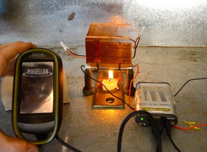

Step 7: Testing
Because Peltier (Seebeck) plates are capable of pumping heat in both directions, you must be careful not to back charge your voltage regulator. Once you know your generator you know it's polarity based on its heat direction.

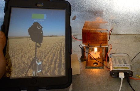

For your first test I recommend a hot plate for a heat source and an incandescent lightbulb for a power test, as the bulb will light up with either direction of polarity. After the bulb lights up, change to your voltage tester and mark the hot wire, this wire will always be the positive when heating the copper plate, and negative when cooling the copper plate.

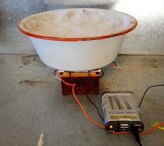

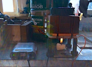

I have been able to Generate measurable levels off of electricity using snow in a warm room, a tea light candle, my truck's tailpipe, and a black metal plate in the sun.
When using a wood stove it is possible to stack two generators plate to plate, to produce more energy, and increase the efficiency of your generator, it also reduces the risk of melting the plates.

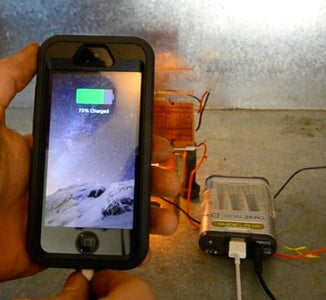

Now you can charge your devices (Cellphones, GPS Units, Cameras, iPads) almost anywhere that you can find a temperature differential.
