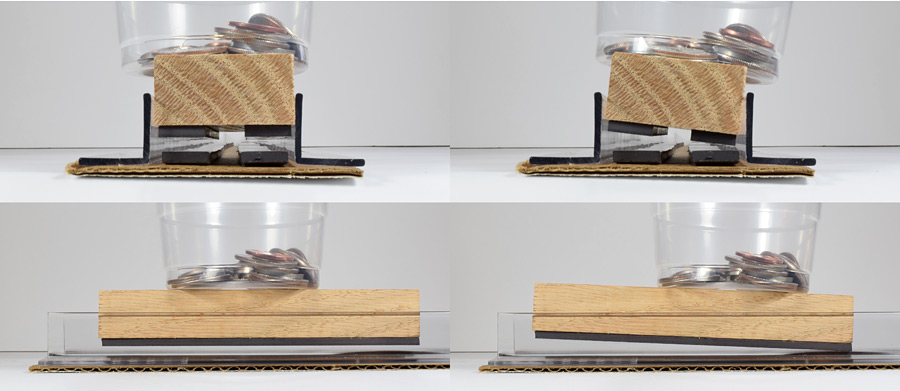

Step 3: Train Design

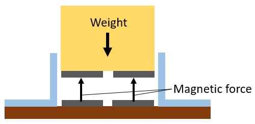

Once you have designed your track you will want to design a train that fits with it. Don’t forget that the most important thing about this project is that the magnets on the train and the magnets on the track must repel each other. That means you will want the same pole facing away from your train as is facing away from your track. For example, if you glued the north pole facing up on your track, you should glue the north pole facing away from your train as shown in the graphic below.
You will want to keep stability in mind while designing your train. The force from the magnets will be very strong, a train that is too small may be hard to stabilize. Consider your track design when starting your train.
- How will you stabilize it?
- Where should your magnets be?
- How many rows of magnets will you need?
Consider your design and test it out. If you would like you can use tape to hold your magnets to your train to test their placement before gluing them. You may want to create a few prototypes before settling on the best design. Once you have decided on a design, construct your train and glue the magnets to the bottom of it, making sure you keep the same pole facing out.
You may also want to go for a different system and stabilize your train from above as shown here.
Step 4: Adding Weight and Troubleshooting
Depending on how you have designed your train, how heavy it is, and how strong your magnets are, you may need to add weight to your train. If the train is too far from the track it will more unstable. To help with stability and get the train really working you will want to bring it a bit closer to the track. Adding weight will help with this. The shape of your train will determine where the weight needs to go. The LEGO example added theirs on the side while the wood block example below used a cup full of coins placed in the middle of their train. If you stabilized your train from above you have already got this step covered.
If your train is still not steady this is where the troubleshooting begins as well.
