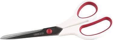

  1. Fabric scissors: The first option is to get scissors online (https://www.amazon.com/SINGER-Fabric-Scissors-Comfort-1-pack/dp/B000YZ8RGA?th=1) Second option: Find a fabric store near you or a hobby store.

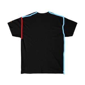

Step 3: Seam Rip the Clothes
Clothing has a lot of material but must be seam ripped to be useable. Here is an excellent video on how to seam rip by the Oliver+S YouTube channel (https://www.youtube.com/watch?v=IQeCpzBTl90) For this project we will need to seam rip the pants as shown in the picture. For a shirt, seam rip and sew it along the lines as shown in the second picture.
