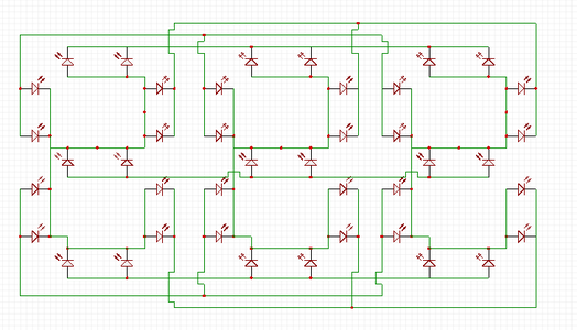

Step 4: Soldamo Iones
time to solder the leds together remember to prototype you don't want to be stuck with an led that dose not work
bend the leds solder them together test them to make sure they are put in that correct way polarity wise
Step 5: Hooking Up
since this is a common cathode setup solder all the cathodes together then add a wire to the anodes repeat this for all the digits
