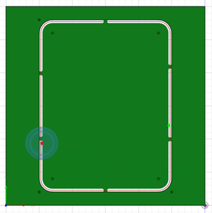

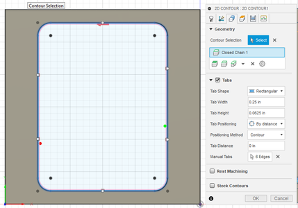

After getting my metal sheet, making a CAD model, and preparing a toolpath, I started making the clipboard mold. I secured the metal sheet onto the CNC Router using double sided tape, and used the router to cut an outline of the clipboard that was the size and shape I wanted it to be. However, while running the program, the double sided tape caused some adhesive to get on the tool bit. Also, there was a sticky protective film over the top of the plate and I think that the tape and this caused the chips to get stuck in the toolpath as it was cutting, which resulted in the finish not being as clean.

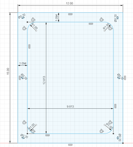

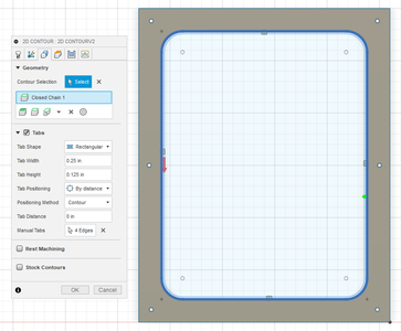

Then, using the wooden board, I used the CNC Router to cut out a jig for the blank plastic clipboard. I secured it to the router by putting screws in each corner, which are also used to secure it later when using it as a jig. Then, similar to the mold, I cut an outline of the clipboard with the router. But the dimensions of the outline had to be a little smaller because I found out that the plastic clipboard shrinks slightly after cooling. Specifically, I reduced both the length (13") and width (10") of the clipboard cutout by 3/16 of an inch (10" - 3/16" = 9.813"). I also made another support out of a small wooden plank that attaches to the top of the jig. I used a table saw to cut about halfway through the plank, about 1.5 inches in from each end. Then I drilled holes on both sides so that it could be screwed onto the sides of the jig going across the middle.

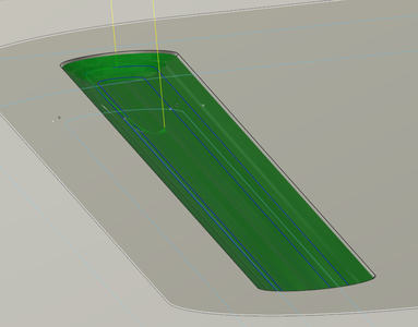

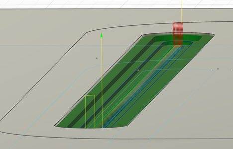

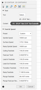

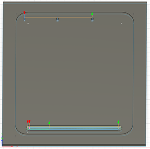

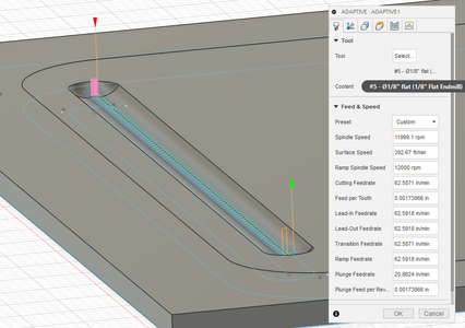

After that, I combined what I had made in the last two steps so I could make the details that are necessary for it to become a clipboard. I screwed my jig into the CNC Router, put my blank clipboard in the cutout, and then screwed the support plank into the jig and router to help hold the clipboard. Then I ran a program on the router that drilled holes for the clipboard clip, a slot at the bottom to hold pencils, and an extra hole in the corner to connect a pencil with some string. In my CAM, I used a drill function for the holes, and then for the slot I first did an adaptive clearing function and then finished with a 3D contour.
