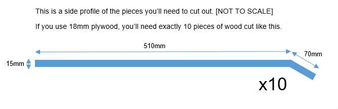

Step 1: Cut.
As per the template above, layout exactly 10 of these blue shapes on a sheet of 18mm plywood. Obviously choose decent wood because you don't want it to break under load...
Try to make the cuts as straight as possible to minimize sanding later on. I would recommend, if possible, using a circular saw for the main straight section, and a jigsaw for the short diagonal section.

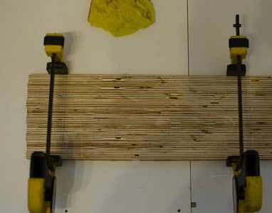

Step 2: Glue.
Once you've got your 10 pieces cut out, it's time to glue the board up. (Hopefully if you're unsure about the whole process, this step will help you visualize it better).
Layout the strips next to each other, with the striped end grain facing upwards. Apply wood glue in between the strips so that you are creating a board as above, with the striped grain facing upwards. Remember to apply copious glue and spread it out a bit (excess is better than too little here). Use some clamps to compress it tightly (but not so tight that it bows upwards).
After the glue has dried, remove the clamps.
