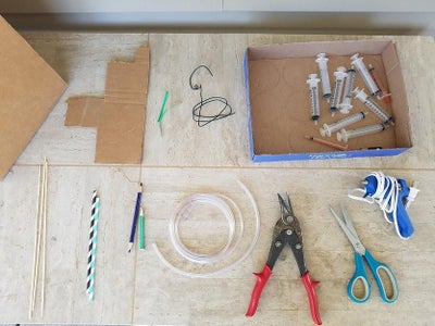

Step 1: Recycled Rubbish Robotic Arm: Gather Supplies
Recycled Cardboard Box
Various Cardboard Pieces
Wire Ties
Recycled Wire Hanger
Repurposed Plastic Syringes
Repurposed Plastic Tubing
Scissors
Wire Cutters
Used Pencil Pieces
Pieces of used straws
Pieces of used wooden skewers
Recycled AAA Battery
Water

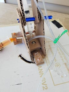

Step 3: Assembling the Base
Make a hole in the bottom cardboard box that is used as the base. Insert a recycled AAA battery into the hole in order to allow the robotic arm to swivel. Attach extra cardboard pieces, using a hot glue gun, to provide extra strength and support around the battery. An extension piece of cardboard with a wooden dowel is used to counterbalance the robot arm. An arced opening in the cardboard base is needed to allow the arm to swivel on the base.

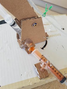

Step 4: Attaching the Robot Arm
Create a hole in both base pieces of the arm as well as making holes in both of the 9in pieces of cardboard. Use a piece of used pencil to attach the robotic arm pieces since it will allow the hydraulic arm to extend and contract. Attach an upside-down 5mL syringe to allow the robotic arm to move up and down.

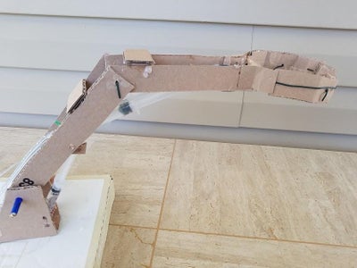

Step 5: Attach the Next Segment of the Robotic Arm
Attach both of the 7 in. pieces of carboard to the robotic arm using recycled pieces of a wire hanger. The wire allows the arm to pivot. Attach a 10mL syringe to allow the arm to further extend and contract. Secure the tubing with a wire tie, and secure the syringe placement with hot glue and recycled wooden skewer pieces.

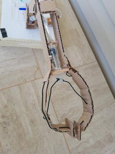

Step 6: The Grasping Grabber!
Curve two 6 in. pieces of cardboard using wire from a recycled hanger. Secure each side to a center syringe which controls the opening and closing of the grabber. Wooden skewers and hot glue can reinforce holding the syringe in place.

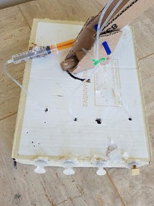

Step 7: Allowing the Robotic Arm to Pivot
A syringe attached to the base allows the entire robotic arm to pivot on the AAA battery upon which the arm is mounted.
Step 8: Secure Tubing and Place Syringes for Controls
Use a twisty-tie to secure all tubing once they have been filled with water. Place syringes on one end of the carboard base to operate the robotic arm.
