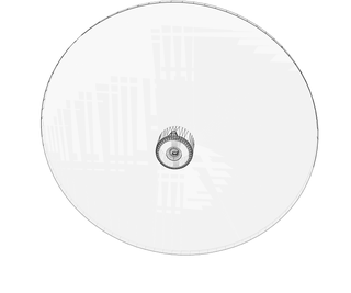

At the beginning of this project I just thought about designing an interface that would allow me to use the used filament rolls. The bigger plate that is conected to the motor came after a teacher asked for a motorized vesion. If you don´t have acces to a motor you don´t need to print the big plate. Just glue the lower part to a piece of wood and you would be able to finish in a couple of hours. (printing time)

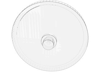

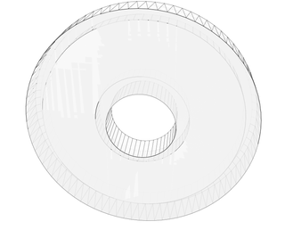

- Big table that work as interface for the motor.
Step 2: Asembling the Parts
I designed the parts with tight tolerances to avoid screws or other things. If you have a well calibrated printer it wouldn’t be a problem to get the right measures.

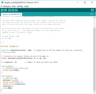

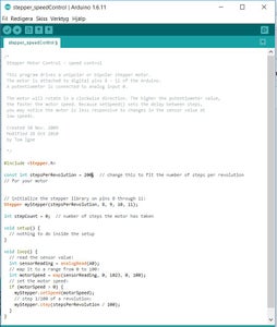

You don´t have to be an expert to be able to control a motor. i just used the sample files that are included in Arduino.
Wiring:
8: Blue
9: Red
10: Black
11: Green
