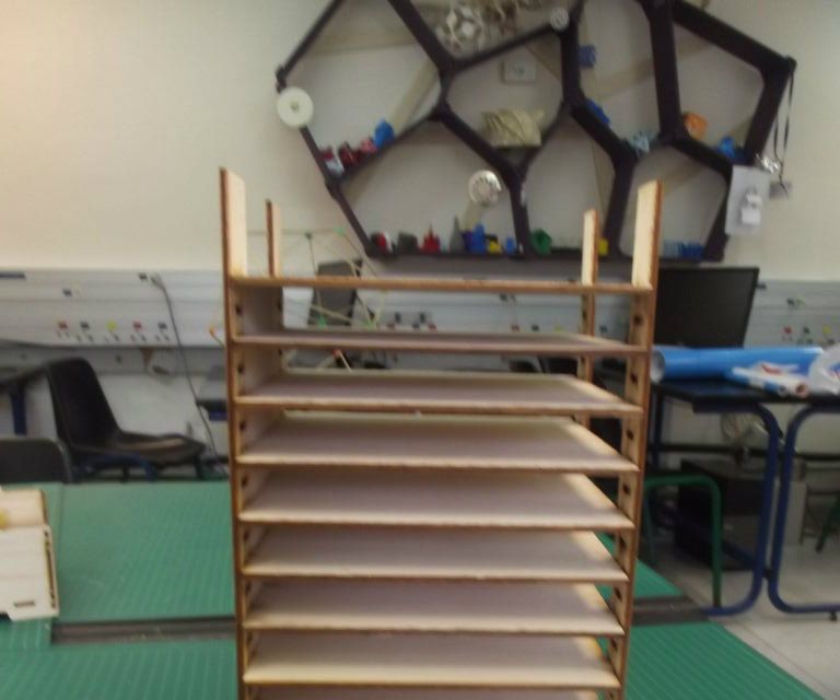

Step 2: Making a Plan: Tinkercad
With Tinkercad free software I Create 3D digital designs. I built a model of the table.
please note that the sizes here are in CM. When you start Tinkercad the unit of mesurement is automatically set to MM.
Step 3: 123D Make
first you must input your materials profile.
in the material section choose the pencil symbol- input your material's sheet size, thickness, and the width of the laser beam in slot offset.
After you get your plans from 123D make, you can cut them with a laser cutter.
note that you choose how many pieces there will be in the intersections, how dense the grid will be and so forth...
I used the interlocking slices technique due to its strength and ability to support weight.
Step 4: Laser Cutting
I cut a fit test- two sets of teeth with different spacings between them so i could check wich spacing was best. to examine the correlation between the slots of the parts.
Step 5: Assemble the Pieces
When making the table itself ( inserting the interlocking pieces) follow the numbering on the pieces. Ask another person for help and don't try to do it by yourself!!
