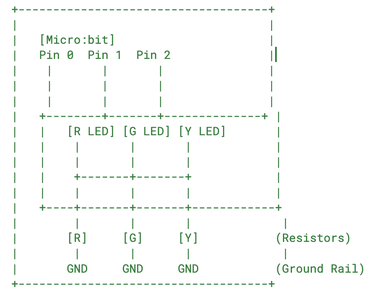

Step 1: Set Up the Circuit
  1. Connect the LEDs to your micro:bit:
  2. Red LED to Pin P0 (for Red Light)
  3. Yellow LED to Pin P1 (for Yellow Light)
  4. Green LED to Pin P2 (for Green Light)
  5. Use resistors to prevent your LEDs from burning out, connecting each resistor between the LED and the ground pin of the micro
  6. Wire up the power: Connect the ground (GND) and 3V pins on your MicroBit to power the LEDs.
  7. Do this on each of the MicroBits.

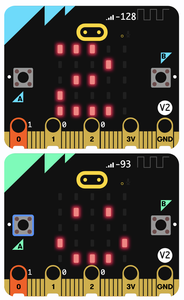

Step 3: Program Player 2 (Runner)
  1. Speed Control:
  2. Player 2 controls the speed of their "running" using Button A (to decrease speed) and Button B (to increase speed).
  3. Stopping on Red Light:
  4. The radio receiver listens for the red light signal (1). If Player 2’s speed is not 0 when they receive this signal, an attempt is lost. Otherwise, Player 2 wins a point.
  5. Feedback and Win Condition:
  6. The game tracks Player 2’s score and remaining attempts. If Player 2 reaches a score of 5, they win the game, and a skull icon is displayed on Player 1’s micro
  7. Player 2 loses if all their attempts are used up, in which case a skull icon is shown.
*The image is using the simulator because it was difficult to get a picture of the radio communication*
Step 4: Code Logic for Radio Communication
  1. Sending and Receiving Signals:
  2. Player 1 sends signals for red, yellow, and green lights using the radio (radio.sendNumber(1) for red, 2 for yellow, and 3 for green).
  3. Player 2's MicroBit listens for these signals and adjusts their speed or stops when necessary.
  4. Handle Win/Loss Scenarios:
  5. If Player 2 stops in time on a red light, a signal (4) is sent to Player 1, who receives it and updates the game status.
  6. If Player 2 fails to stop in time, signal 5 is sent, and Player 2 loses an attempt.
