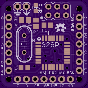

A 1" by 1" board (will fit in breadboard if 2 opposing rows are populated) and will fit in a perfboard
The Atmega328P-au
A 16 MHZ crystal setup
pull-up reset resistor
Built in Power-LED In your choice of colour
plenty 'O headers

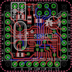

All the necessary pins are broken out for your project including reset - the new board has an updated silkscreen with pin functions labeled as well (pictures are of slightly older board)

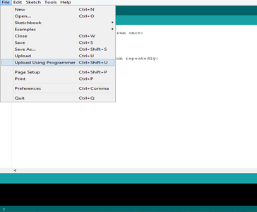

Shipping - orders made before 12 AM GMT will ship before 7:30 GMT that day on all business days. Parts come in small Jiffy padded envelopes with extra bubble wrap - inside antistatic bag with quick reference assemble instructions as well as a checklist and Serial Number. Full assembly instructions will soon be up on instructables.com but it should be plug and play so for now just give a call if you need help. To program plug into ISP and use >UPLOAD USING PROGRAMMER on Arduino IDE having selected your programmer

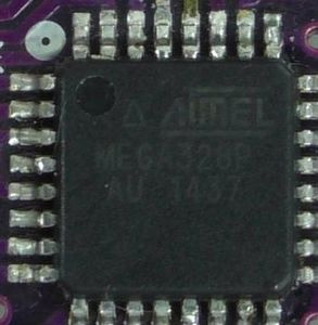

Soldering the chips can be tricky but is do-able
Tweezers are used to hold the package and the polarity means the circle in the chips corner should match up with the one shown, Your flux pen will be used a lot so get it ready - use it with gusto whenever reflowing solder as the flux that is in the core has already gone. Use your solder wick to mop up any spills and bridges

C1 and C2 are identical and shown on the insert slip (small browner package without marking)
R2 is marked 201 and is 200 ohm for the LED
R1 (moved to allow mounting hole on new models) is 103 and 10K ohms for reset pullup
Crystal is 16MHZ
LED is well, an led, and the smallest - positive goes to board edge

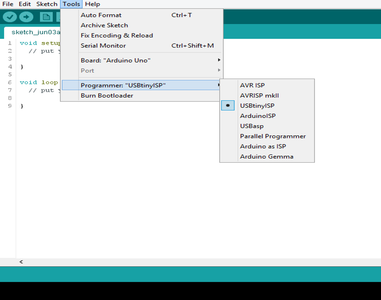

Whether a kit or a pre assembled model the board is setup as an uno and running blink - all models are tested before shipping. To program the board an AVR isp is required - stay tuned on my store for a 12 dollar AVR isp I'm currently working on! but for now a USBtinyisp or AVRISP MK2 or even an uno running the Arduino ISP sketch! simply plug the ISP header (check orientation - dot is pin 1) in to your programmer and write data as an Atmega328p or UNO.
To use the Arduino IDE select your programmer after plugging it in (no need to select port) and then press upload using programmer. (see above)
