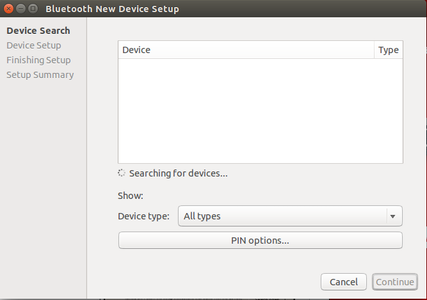

Linux
In Linux you can use the bluetooth manager to pair the device, you will find the device and then in the PIN options you can use the 1234 PIN number.
That will take care of pairing the bluetooth device, but you still need to test the connection.

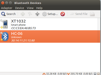

You also need to install blueman, in Ubuntu you can run:
sudo apt-get install blueman
Then run the blueman-manager with sudo privileges
sudo blueman-manager
The bluetooth device will appear with the HC-06 name and the MAC address.
Right click the device and click on "Serial device" that will take care of connecting it.

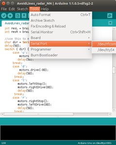

When looking at the arduino IDE you will also find in the Serial port menu the new bluetooth port.
