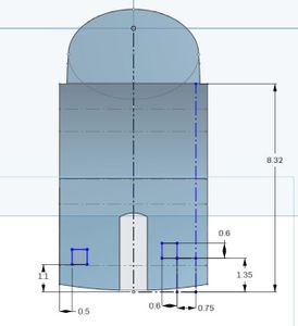

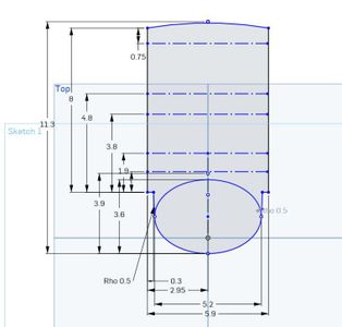

Step 2: CAD Top Shell Structure- Top View
First, you need to use a measuring instrument (I used a set of dial calipers for more precision) to measure the total length and width of the top shell's outline along with any common shapes such as ellipses and circles. I recommend taking repeated measurements to ensure accuracy.
When creating the CAD drawing (I used OnShape as my software) for the new mouse design, I ppicked some points at the shell where the curvature and height have significant changes to create construction lines. Doing so, will allow you to easier change the shape of the mouse in terms of the height at different points.
After determining my points and shapes, I created a general outline and fill out the dimensions in the new sketch, similar to the picture above.
*All dimensions are in centimeters.

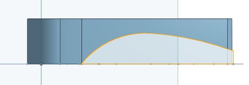

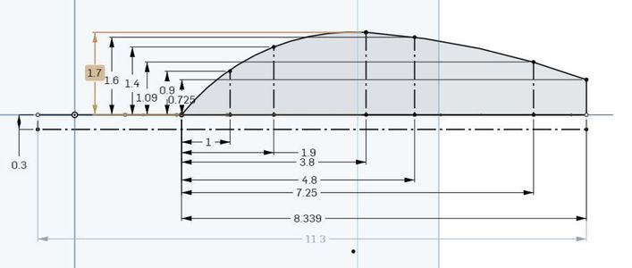

Step 3: CAD Top Shell Structure- Side View
Next, I created a side-view sketch for my design, this will be used to represent the existing bottom shell. I inserted the measured dimension of the height and length at each point.
I made sure to give the height of the existing material of the bottom shell, and not the desired height of top shell.
After filling out the crucial points, I connected the points at the top with 3-point curves to fill out the sketch. I left the radius of the curves undefined for the moment in case I needed to edit the curves to adjust for the height of the shell itself.

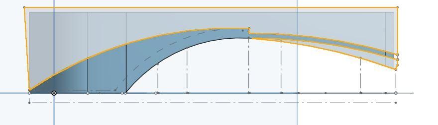

Step 4: Basic Extrusions
I then extruded the top view sketch from Step 2 with the standard depth of 2.5 cm to create the block of material. In the next steps, I remove CAD features to create the needed shape.
Step 5: Side View Material Removal
To create the basic shape, I used the side sketch to remove material through the entire block.
I made sure to have the second end position selected and have the "through all" option selected for the position to truly have the removal through the entire block.

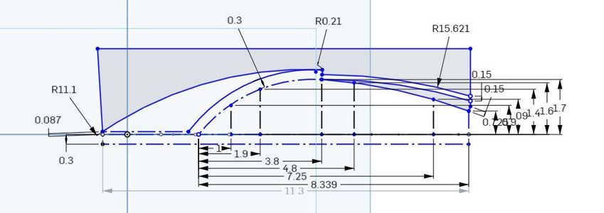

Step 7: Side Sketch for Top Shell Shape
Next, I copied and pasted the original side sketch onto a new sketch, then offset the flat tail end by 0.087 cm, offset the middle curve that consists of 3 crucial points by 0.3 cm, and finally offset the tip of the curve by 0.15 cm.
Then I connected the offset tail to the middle portion and later the middle curve to the tip of the curve by another 3-point curve to round off the sharp edge similar to the picture above.
Lastly, I created another 3-point curve that connects the shell's tail end to the very top of the shell itself to allow room for the led and fiber optic cables. (I used a radius of 11.1 cm)

Step 10: Extension Sketch
I created the clicker extensions so the mouse shell would hit the sensor. I created 6x6 mm squares and positioned them where the sensors are located in the actual mouse.
I used construction lines as references and to set the position of the sensors as shown in the picture.
