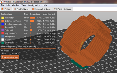

In this print of a stepper motor fan shroud, although warping still occurs, the damage is mitigated, and a dimensionally accurate useable part is still produced.

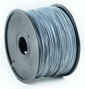

  • 1.75mm ABS Fillament

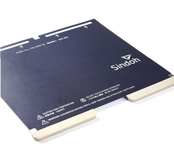

Spray the flexible print bed with a clear spray glue, wait for it to dry.

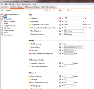

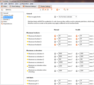

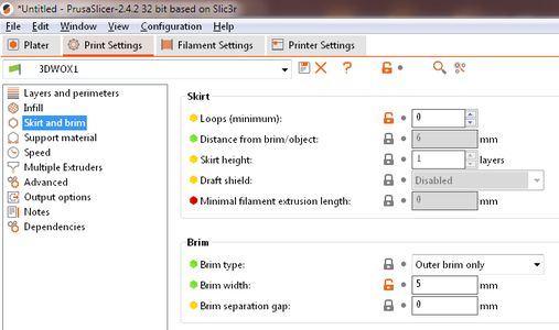

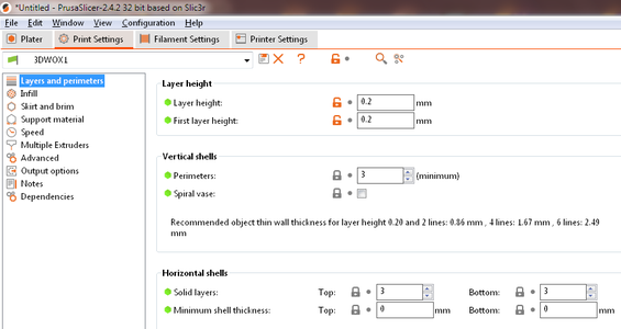

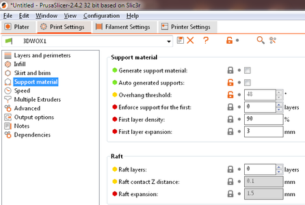

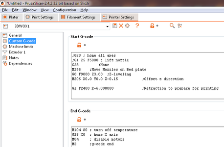

Step 2: Configure the Prusa Slicer Settings
One solution to combat ABS warping is to:
  • use slow printing speeds <=40mm/s
  • 0.2mm layer heights
  • 15% Infill

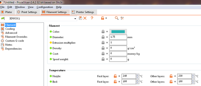

  • 230 Degree Celsius Nozzle Temperature, 100 Degree Bed Temperature

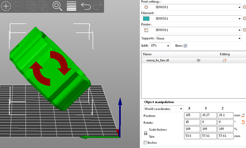

  • print the object at 45 degrees without supports.
Here is a complete .ini file to import into Prusa Slicer

Although the estimated remaining time displays as 0h 0m during printing the Prusa Slicer is consistently produces gcode that results is dimensionally accurate complete prints.
In this long print, the object rests on a 2mm chamfered corner, some supports around and a 6mm brim around. There is much less warping than if the object was printed with the flat bottom edge on the bed.
