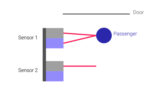

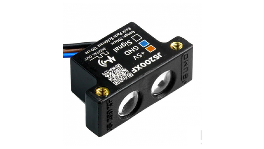

Optical infrared sensors mounted on the bus doors can count the number of passengers that enter or exit the bus.
There are two sensors mounted next to each other placed close to the door. Each sensor contains a transmitter and a receiver. The transmitter constantly sends out pulses of light.
When a passenger walks in front of the sensor (sensor tx/rx pair is triggered), the transmitted light is reflected back to the receiver.
The system can sense two scenarios: Enter and Exit.
Enter: When Sensor 1 is triggered before Sensor 2, it is assumed that a passenger has entered the bus.
Exit: When Sensor 1 is triggered after Sensor 2, it is assumed that a passenger has exited the bus.
