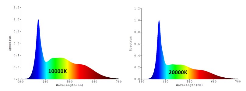

Determine Colors
Using the chart above: https://orphek.com/correct-corals-spectral-needs/ and the chart from https://www.reef2reef.com/threads/lighting-spectra-photosynthesis-and-you.100170/ you want to maximize chlorophyll A, cholorophyll c, and Cartenoids, with the majority focus on chlorophyll A as it outnumbers C 10 to 1. They are not typically know to use chlorophyll b and f. Therefore the best additions are in the 400-500range range and the 660nm range. 425nm, 465nm and 655nm were chosen in addition to 10,000-15,000K white lights. The white light is intended to fill in everything in between as you can see in the graph above for 10,000 and 20,000 white lights: https://www.reef2reef.com/threads/20000k-and-30000k-led-spectrum.725445/#post-7543880, though the focus in on the blue lights and the red light. Indiviuals may adjust as desired to try different amounts for their setup.
Current setup:
  1. 2 blue (465nm) at ~100W total
  2. 4 white (ranged see chart above) at ~ 150W total
  3. 2 UV (425nm) at ~100W total
  4. 2 red (655nm) at ~50W total
While this is a start, make sure to verify PAR is sufficient for your corals at the final step
