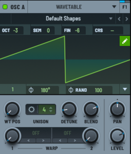

In the top left add two saw waves to both wavetables 1 and 2. The blue button turns on the wavetable and a small selection can be found under the basic shapes menu option. Saw waves are warm in sound and saturated wavetables and often serve the foundational basis for reese basses.

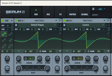

Step 2: Voicing Using Unison and Detune
Increase the unison for each wavetable by clicking the number 1 above “unison” and dragging up, turn the detune down until, by using the labeled detune knob, until the sound cleans itself up. This adds the stereo width and phase shifting iconic to reese basses whilst starting to introduce the unique characteristics of your bass. How much phase shifting is subjective and something that should be played around with.
Step 3: Further Detune the Saws From Each Other
Fine tuning, abbreviated “FIN”, allows the wavetables to be played against each other slightly out of pitch and adds more character. This is subjective and should be done to the likings of each producer. The Octave, abbreviated “OCT”, was moved to minus three to put the base in the lower frequencies, usually the lowest harmonic sits between 40-120hz.

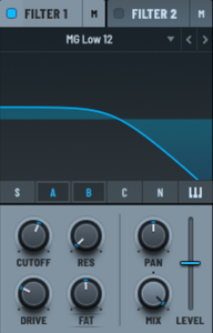

Step 4: Filtering
To the right of the wave tables a low pass filter is applied usually between 600-7000hz. Turn the filter on by clicking the Blue Square in the top left corner and in the upper right corner click the arrows until one says MG low. Adjust the cut off, resonance, drive, and fat to personal preference. This is used to keep basses in the lower frequencies and save space in the sonic spectrum for other musical elements.

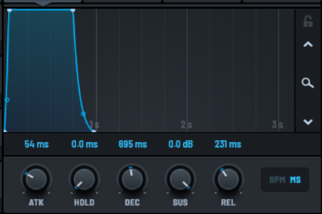

Adjust sound with ADSR;
Increasing the attack and release will make the sound start and stop smoother. ADSR stands for attack, decay, sustain, and release shaping a sound's characteristics over time.
Glide with portamento;
In the bottom right adding legato and long (200+ ms) portamento will create the iconic gliding between notes. Portamento means a slide from one note to another.

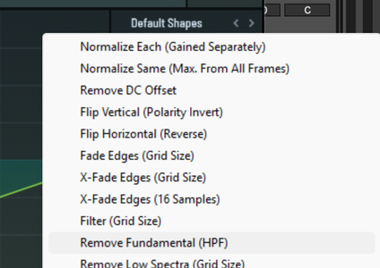

Sub bass stability by removing the fundamental;
Hovering your mouse over each wavetable will pop up a green pen, click it.
Once at this screen click the arrow that says "all" to the right.
Click remove fundamental.
Do this for both wavetables, then click the green box next to “Sub” to turn on a sub base. This sub base will replace the fundamental of the saw waves. This will gain your reese base clarity and sustain whilst reducing a bit of the phasing character
