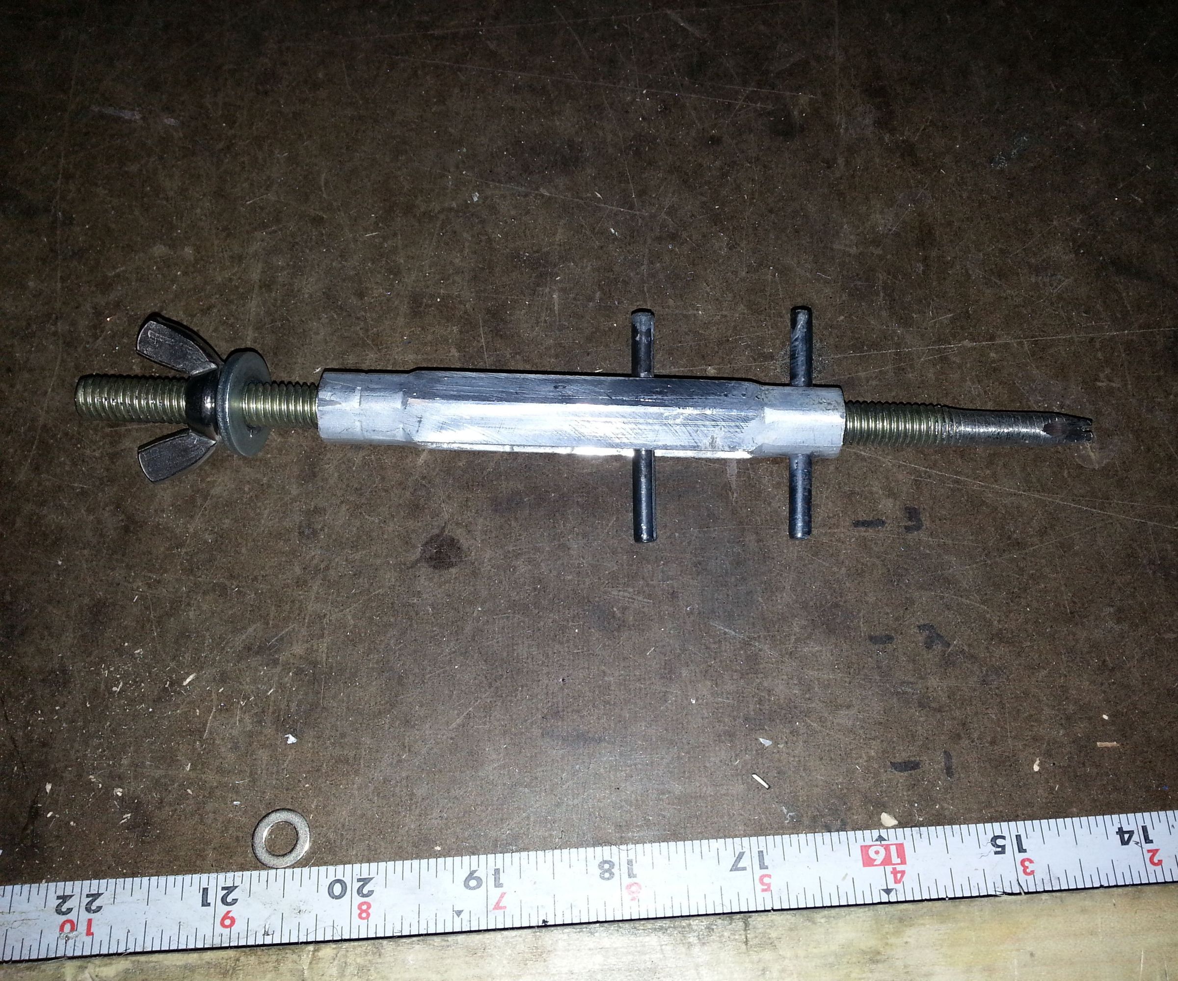

The core tool has a little slotted post for valve removal and installation.
Remove both of the valve cores (the red banded thing in the third picture).
