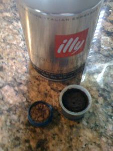

Step 2: Capsule Breakdown
This just shows the three pieces of the capsule. The bottom is in the upper right and it is just a snap on cap.
The body is shown upper left and you can see the filter screen at the bottom of it.
At the bottom is the removed top piece, shown upside down. It has a filter disk in it. The top piece just slides into the body and sits flush on a ledge the runs around the inside rim of the body.

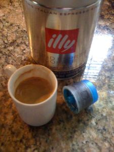

Step 3: Espresso!
Here's a cup of espresso made with Illy espresso coffee from one of those familiar cans. The capsule lying on the counter is one where the top can be removed to add coffee.
Frankly, the espresso is better from a fresh capsule, but this method works fine if you have coffee that needs to be used up or if you run out of capsules.
