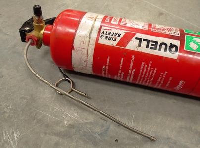

Step 3: Remove the Gauge and Fit the Valve
Next on the list is removing the gauge, fitting the valve.
- The gauge is very tight but will unscrew (the extinguisher is empty right?)
- The gauge can then be pried off the fitting
- Drill the fitting out to accept the Schrader valve I used a 5.5 mm drill yours may be a different size I used a lathe to do this but you could drill it out with a drill if you don't have access to a lathe
- Make sure everything is clean as solder will not stick to dirt or oxidized metal
- Solder the valve to the fitting
- Cut off any excess so the fitting seats properly when screw back in
- The valve can then be fitted to the extinguisher
- The core can now be fitted
Step 4: Harvesting the WD40 Can
First on my list is the cool bendy nozzle hose pipe thing on the WD40, I found that it kind of unscrewed, just twist it and it came right out.
- Next remove the nozzle from the fire extinguisher it just unscrews
- I drilled out the nozzle to accept the bendy nozzle, 3.2mm drill
- I also cut the end of the nozzle off, but it would probably be better just to fill up the cavity with silicon after the bendy nozzle is glued in
- Super glue the bendy nozzle hose into the fire extinguisher nozzle, and refit to the extinguisher.

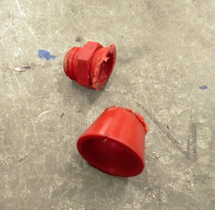

Step 5: Saftey and Packaging.
When I asked the fire extinguisher service guy about refilling the cylinder, he pretty much said it was not a problem but you must make the extinguisher look like something that could not be mistaken for and extinguisher.
In an emergency people do some silly things so it needs to at lest have the label removed and painted any color but red.
- The top unscrews from the cylinder (make sure its empty first)
- The label can be remove by heating the cylinder up, it softens the glue and can be pealed off.
- I sanded the paint with scotch bright and painted it blue.
- The (empty) WD40 can had the ends cut off with tin snips then cut up the middle.
- I cleaned the inside of the can of any oil, then slid it on the cylinder glued it to stop it coming off.
