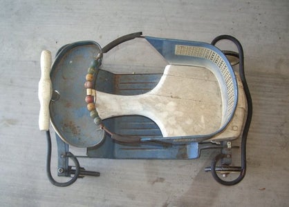

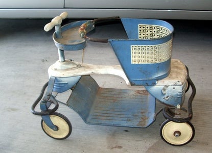

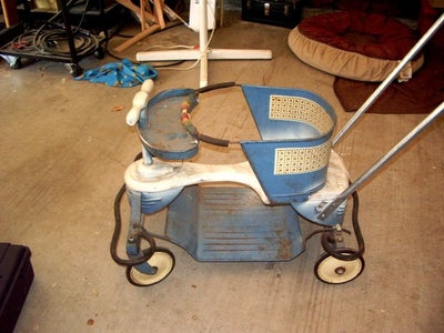

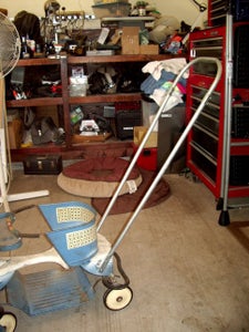

My wife and I picked up an old metal stroller at a flea market recently, and decided it needed to come home with us in preparation for an upcoming grandchild!  These old metal strollers were popular in the early '50"s,  and were built like tanks.  Unfortunately, however, even tanks start rusting after they're abandoned.  Most of these old strollers eventually found their way into backyards, barns, and junk piles after they were no longer needed.

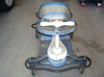

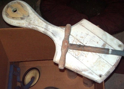

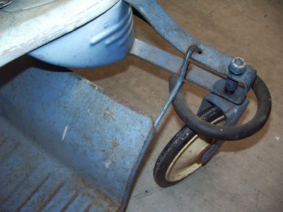

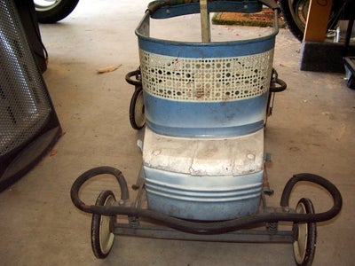

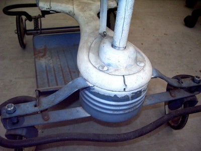

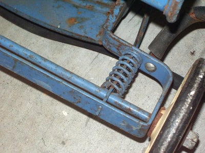

This stroller had begun rusting, but other than a very small bit of pitting, most of the rust was just on the surface.  The seat and grab bar were made of wood, and it appeared that somewhere along the line someone had "slapped" (literally) a bit of paint on it (and dribbled it everywhere), and this paint had begun checking and flaking off.

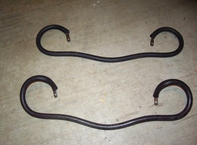

The front and rear bumpers were made of 3/16ths steel rod, and the rubber covering was rock hard and had started breaking off in chunks.
The stroller's handle was missing, the body was beginning to rust, the wheels squeaked, and.....well, you get the picture. The thing totally needed refinishing, but the good news was that the only thing missing was the handle -- all the other parts were there.

Step 2: Make the Missing Parts

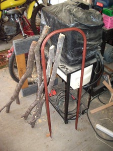

Before dissembling the stroller, I decided to start this project by making a new handle.  This turned out to be pretty simple.  I took two lengths of 1/2 inch metal electrical conduit and flattened 4 inches at one end of each piece using a vice.  These  pieces became the two sides of the handle assembly.
Since I don't have a conduit bender, I bought two 1/2 inch metal elbows and two couplers.  I spliced the metal elbows together using an oak dowel and epoxy adhesive to make a new handle, which was attached to the side pieces with the couplers.  This made for a simple, but sturdy handle.
To attach the handle to the stroller, I drilled holes in the flattened sections of the side pieces to match the holes that were on the stroller body.  I didn't attempt to build a folding handle (since we'll only use this when our new grandchild comes to visit), but if we did want to transport the stroller in the car, it would be a simple matter to remove two of the four bolts that attach it to the stroller and fold the handle forward.

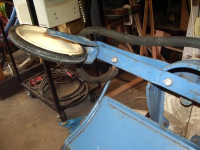

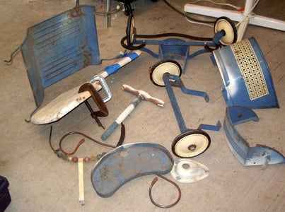

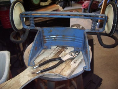

Step 4: Take It Apart

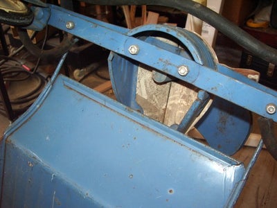

Next, I took everything apart that would come apart.  I tried to follow a logical progression -- removing major components such as the front and rear wheel assemblies, then taking apart those assemblies.  I was fortunate that none of the bolts were rusted together, and none of the screws snapped in two.
Taking things apart is reasonably easy -- it's the putting them back together that usually the challenge!  That's why I took the photos before i began.

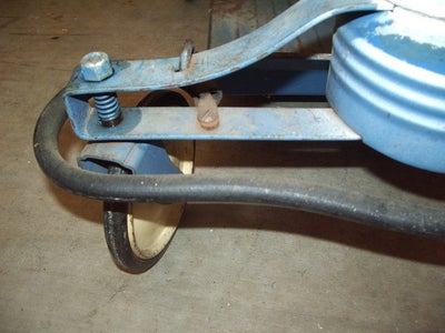

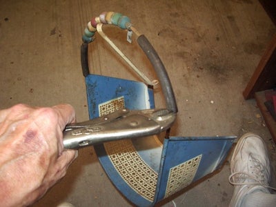

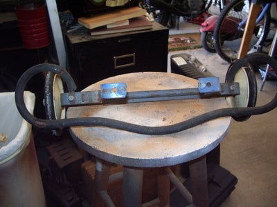

My next step was to identify any parts that I needed to replace.  The squeaking wheels were fixed by using a little oil, but unfortunately the rubber covering over the bumpers was beyond saving.
The rubber on the bumpers was extremely brittle, and had to be replaced.  I thought, "Where oh where can I get rubber bumpers for a 60 year old stroller?"
Of course, the answer was simple -- in the plumbing department of my local home improvement store!  Quite often when I'm faced with needing a part that can't be found anywhere, I've found that more often than not I can find something that works in the plumbing section!
What I found in the plumbing section was a set of black inlet hoses for a washing machine.  These hoses had the same outside and inside diameters of the old bumper coverings, and were the exact same color (black)!
I cut the ends off the hoses (guess that voided their warranty) , and began pushing the hose over the steel bumper.  It turned out to be tougher than I initially thought, due to the friction between the hose and the curved areas at the ends of the steel bumper.  WD-40 to the rescue!  Squirting just a little bit of WD-40 inside the hose made a huge difference.  I slid the hoses onto both bumpers and trimmed off the excess.  Now the bumpers looked just like the originals had looked when they were new.

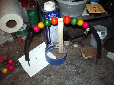

I also replaced the wooden beads in front of the tray with new one's, and replaced the old hardened rubber covering with a piece of hose left over from the bumpers.

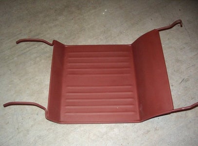

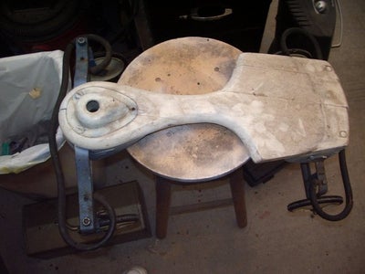

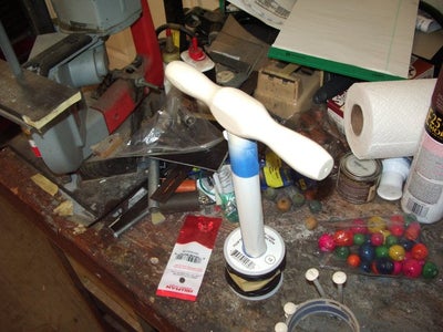

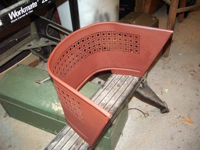

Next, I began the sanding process beginning with the wooden parts -- the seat, the grab bar, and the post the grab bar was mounted on.  After the initial sanding, I then used a wood filler on all cracks and dents, and sanded again once the filler had cured.  I began sanding with 120 grit  paper, then worked my way down to 220 grit.
The rust on the metal parts was first attacked with a wire brush to get into all the nooks and crannies.  Then I sanded each piece first with 220 grit paper, then moved to 400 grit.

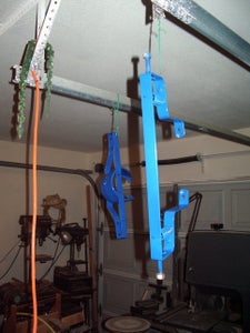

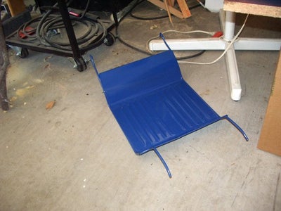

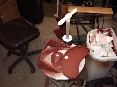

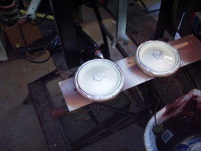

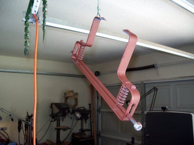

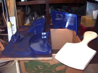

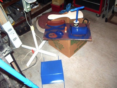

Once each metal part was sanded, I cleaned it with mineral spirits and sprayed with Krylon rust resistant primer. I then set these parts aside for two days to make sure the primer was fully cured.  Before painting the wheels, I put tape over the tread.
Step 7: Paint

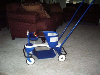

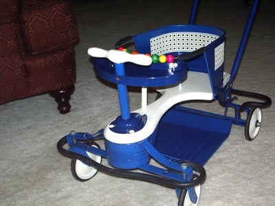

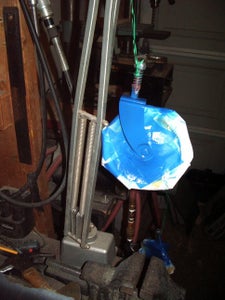

After the primer had cured, I sprayed the parts with Krylon paint.  A couple of the parts were two-toned, so after the initial coat dried, I taped off the area and sprayed with the other color.  After everything had dried, I removed the tape and began putting everything back together again.
Step 8: Reassembly
Reassembly was fairly easy, since I had pictures for reference.

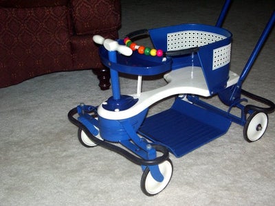

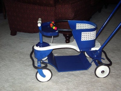

All that's left to do now is wait for the grandchild!
