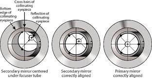

Step 6: Calibration
Now we can calibrate the telescope so that the primary mirror, the secondary mirror, and the eyepiece/camera can align perfectly. A simple step to do this is to cut a piece of paper into a circular shape so it fits on the eyepiece. We can then poke a hole through this piece of calibration paper, put it on the eye piece, and look through the hole. This piece of paper ensures that the light rays will be going through the eyepiece parallel.
If you have done this correctly, you will be able to see something similar to the first image of the following picture, and our goal is to make it look like the last one.
Looking through the calibration paper, you will see the secondary mirror, a reflection of the primary mirror, and a reflection of the eyepiece. This can be a little challenging at first to identify all of the parts, so take your time!
Once you have identified all of the pieces through the calibration paper, you can first try to move the secondary mirror around so that the reflection of the primary mirror is centered just like the second image. Then, you can try to adjust the primary mirror if the eyepiece is not centered (the eyepiece should be already centered if the primary is well-aligned).
After all these steps, if every optical piece is centered in your field of view, the telescope is well-aligned, and you are ready to observe!

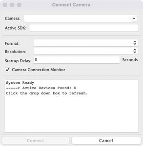

Step 8: Connecting the Camera
We used software called AstroDMx, which is really easy to navigate. After connecting your camera to the computer, you can click on the "connect" button and choose the camera you want to use under the "Camera" tab. You can also choose your desired format and resolution. After connecting, you will be able to see a continuously updated image of what the camera is capturing. You will be able to change the exposure time, contrast, saturation, etc. Depending on the type of object you are observing, these values should be changed accordingly.
After the telescope is focused on your target, you can click on the "capture" button, which captures the images continuously until you hit the "stop" tab. You will be able to save the image as different file types. We saved our images mostly as .fits and .png files for easy visualization and editing.
