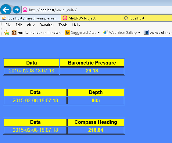

In my first Instructable "Getting Arduino data to a web page" I talked about refreshing the data by using the Meta command to refresh the MySQL data content. The problem with this is that it refreshes the entire page and could possibly interfere with other scripts as well. Not to mention the annoying blinking. So I have made a couple of improvements that might just make things work together a little more smoothly. This Instructable uses the same files as the original project with the exception of adding two "php" files "clock.php" and "update.php" as well as modifying the "index.htm" file. The files can be downloaded at the bottom of the page. To view the web page updating watch the video file below.

I began with the problem of how to update information from the MySQL database first. After some research, trial and error I determined that the best way to do this is put my PHP scripts in a separate PHP document then update the document with the meta refresh command. This continuously updated the data! I then found a jQuery script that would refresh anything within a "div or span" html tag. I then put the two together and "wala" data refreshing without refreshing the entire page and content!!
The Script above is from the Index file and is used to update the MySQL data without refreshing the whole page. The "update.php" file is used here, but you can replace the files and the "id's" within the div or span tags with your own names. Once again this only updates the HTML file and not the PHP file.
