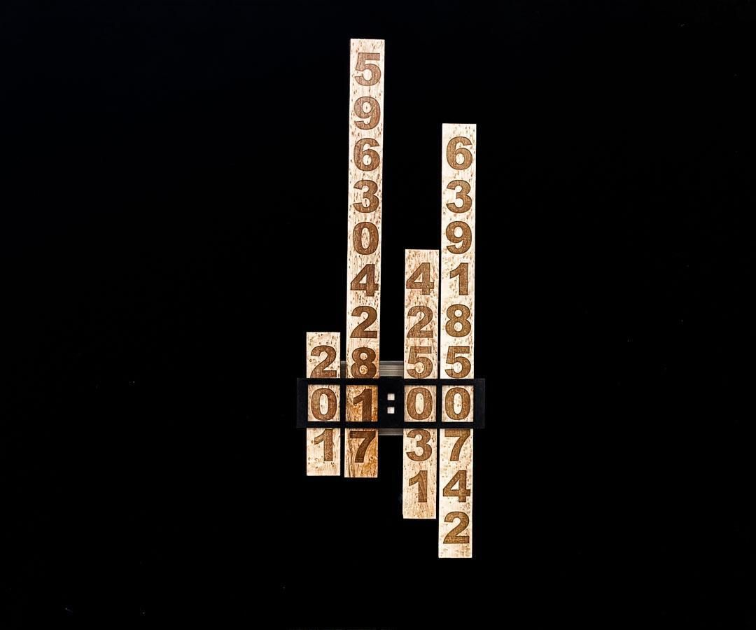

I've always been fascinated by unusual clocks. This is one of my latest creations that uses refrigerator alphabet numbers to display the time.
The numbers are placed on a piece of thin white Plexiglas that has thin sheet metal laminated to the back. There are small magnets in each of the numbers that cause the number to cling to the sheet metal when they are not being moved.
The numbers are moved using CoreXY mechanism that moves a carriage behind a number, it then engages two magnets which attract the magnets on the number and allows the number to follow the carriage movement. Once at it's destination the carriage magnets are disengaged and the number will stay in place because of the thin sheet metal backing the Plexiglas.

I 3D printed all of the numbers used in the clock. There are are 10 digits for the minutes and hours (0-9), 6 digits (0-5) for the tens of minutes, and 1 digit (1) for the tens of hours. These were printing using various PLA colors to add variety.
