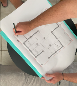

Step 1: MEASURING THE STICKS
In this part we measured each stick's lenght in the scale we created our model in.

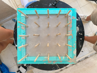

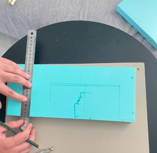

Step 4: CREATING THE MOLD AND FIXING THE STICKS
Polysterene was used as a mold for the plaster because it is easy to cut in home and generally to use
Step 5: POURING PLASTER AND REMOVING THE MOLD
The mixture must be on the liquid side. Pour from one side an then move it around for an equal result.

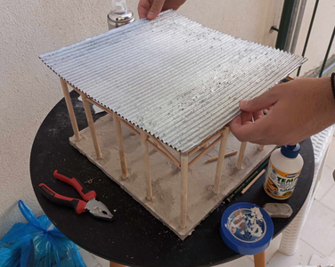

Step 7: PLACING THE ROOF
The roof is made out of cardboard, painted with acrylic spray then glued on.
