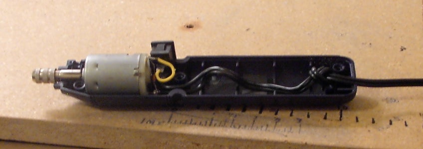

Put the switch in first, then position the motor where its not in contact with anything
With the roto-matic the motor seems to sit at a 45 degree angle
Loosely tie a knot in the wall warts cord and fiddle with it as you tighten it so it forms a strain control near the bottom of the case, with a little bit of slack inside the unit

Put the other half of the case back on, make sure your not pinching wires, and that the switch and chuck lock line up
Put the screws back in, I found it easy to put the larger case screws in first
Now you have a useful (altho still light duty) rotary tool

There is more vibration, since there is not any battery dead weight to help damp it out, altho I don't recall it being any quieter
All in all I put some junk i had to good use, kept some toxic battery, plastic, and electro waste out of a landfill, saved some money, and ended up with a tool that is adequate for my uses

which there was some concerns about powering a drill off of a wall wart, altho my little dremel wannabe is not going to see the loads that a drill would, it made me go back and think
SO, I ripped it back apart, disconnected the + power lead, and put my multimeter in series with the circuit, set to check the amperage
Without a physical load on the motor, it was drawing 0.490 amps, more than enough for the 2.5 amp supply
Sanding down the edge of a PCB, it was hovering around 1 - 1.5 amps, still fine for the 2.5 amp supply for what I would consider a reasonable use, taking into count I was pushing quite hard and dragging down the rpm to nearly stopping
But when I halted the motor with my fingers the draw shot up to 3.2 amps, and then the switching supply kicked in its overload protection, keeping it fairly steady, but if I continued it for a long period of time the supply would still most likely heat up (I did not bother to push it)
I decided to install a fuse holder, and a 2 amp fuse (probably a slow blow), but by the time I did all this, it was nearly 7pm on a Sunday, and the closest Radio Shack (located in a mall) had been closed for almost 50 min
I will have to wait until tomorrow to do this, and when I do, I will update my instructable
Why not just use a bigger rated wart? because that really doesn't solve the problem, the motor is going to suck down whatever amperage it can get, using a higher rated supply just puts bigger numbers on my multimeter
Is it really necessary? probably not, but as my old electronics teacher would say, "its better to be safe than on fire"
