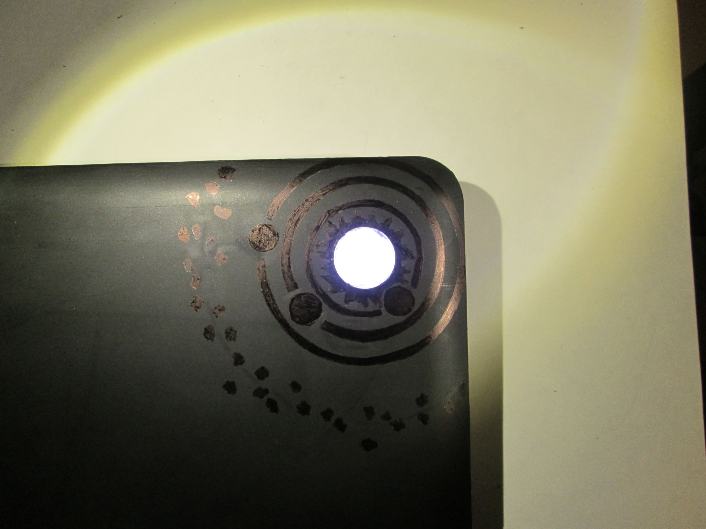

Step 6: Minor Aesthetics: the Logo

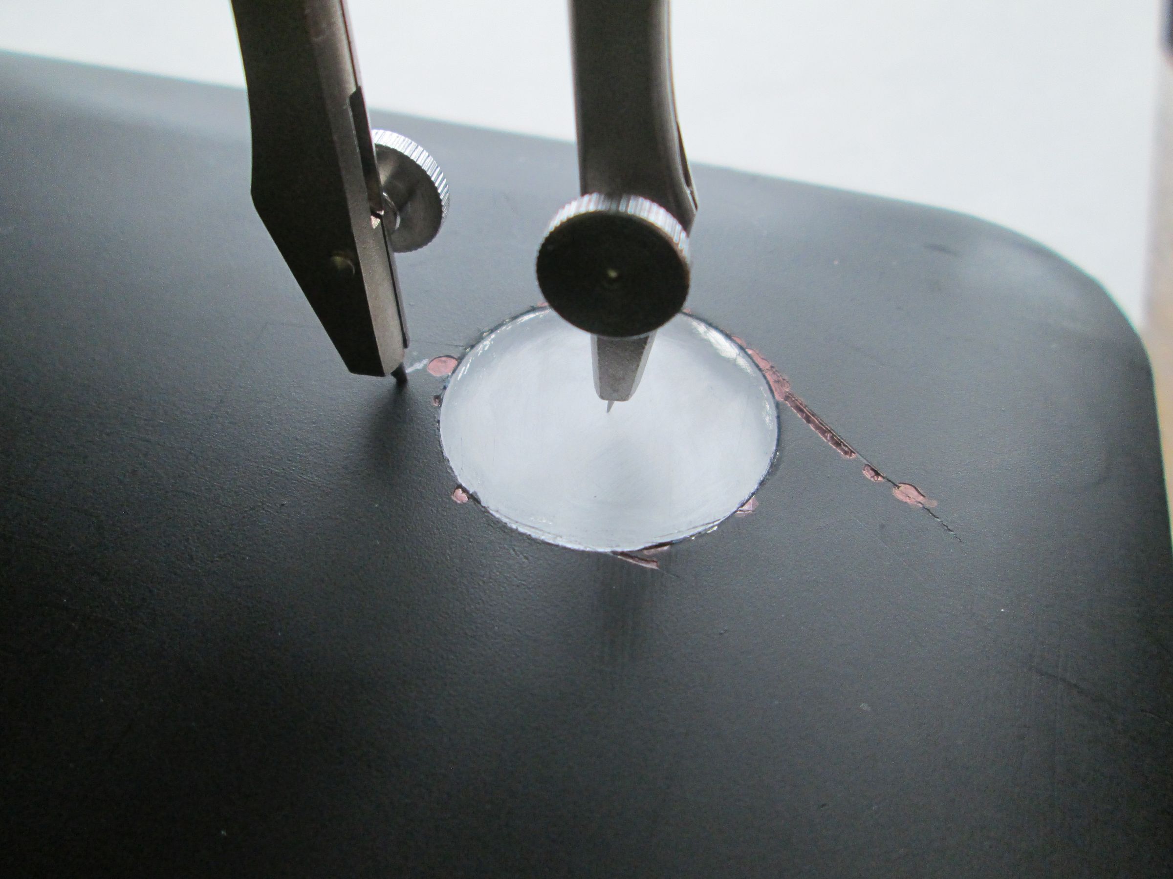

Just for fun, I'd like to change the HP logo on the back. I also wanted to do it in such a way that it could cover up the scratch I had made earlier. To change the HP logo, I covered the basic area with tape so that I then cut the logo shape out of, revealing only the HP logo and leaving the area around it protected. After this, I simply sanded off the paint, revealing a nice, circular surface on which to do my work.
You may recall my mentioning that I fell to the temptation of removing the tape too soon, and this, combined with an accidental incision from the knife when applying tape, meant that I had to cover up a mistake. I started by using sharpie, but it doesn't do a great job of covering up the scratch, although it does help. Instead, I decided to go with it, and create a small solar system, using pencil to plan it out and then sharpie to finalize my work.

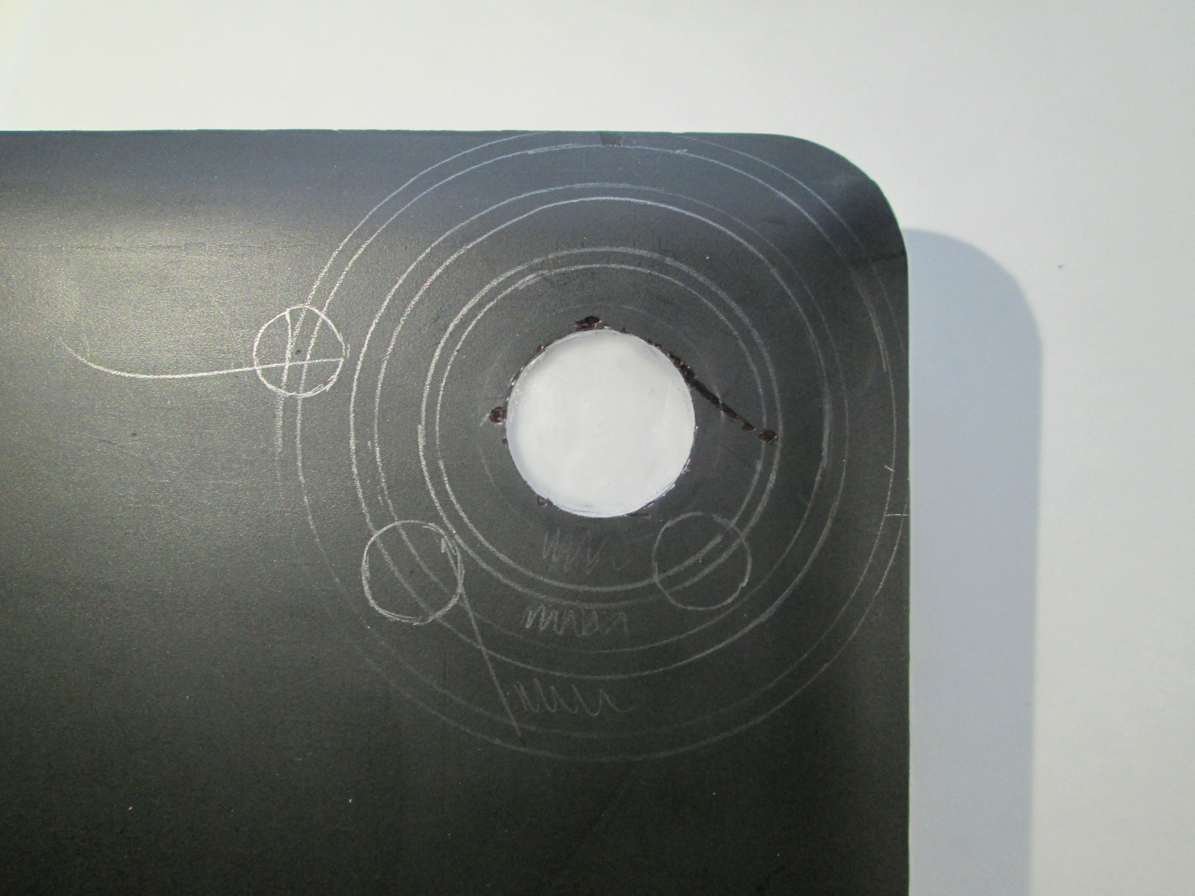

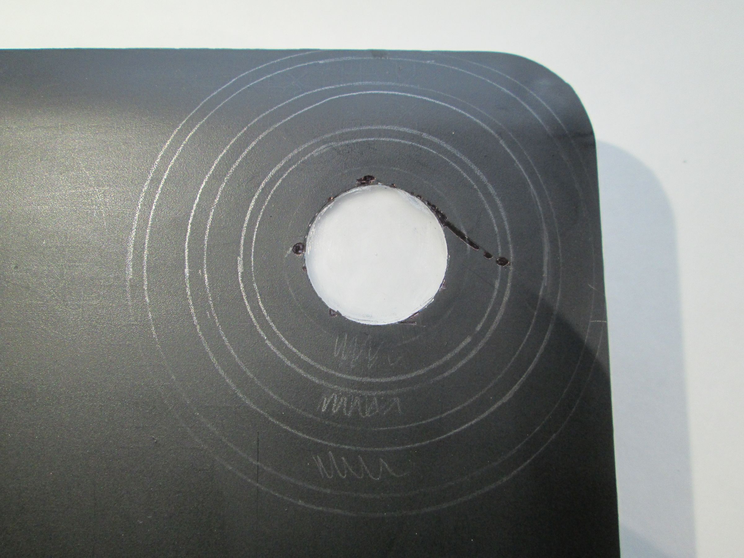

To do this, I started by creating 6 rings that would be the orbits of my small planets. I found a compass to be very helpful, as it allowed me to create 3 thin ringed areas of a good distance apart.
Again with the compass, I created three planets to fit in the orbits. The stray pencil marks are from when my compass slipped slightly, since I was creating small circles on a slippery surface.

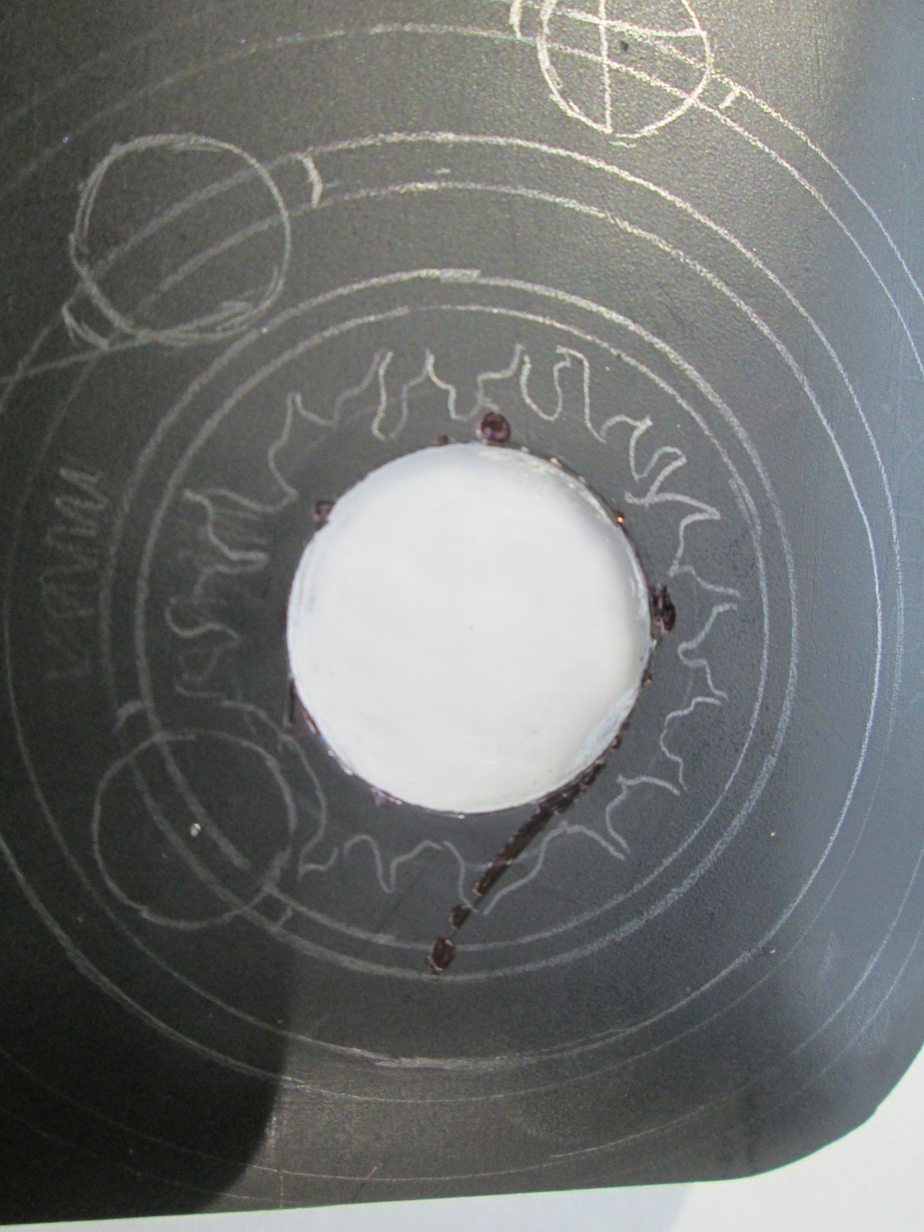

I then drew out an outline for the sun at the center. I find this to be particularly fitting because in the case of my computer, the logo glows, so that in this design, when the computer is active the center of the solar system's sun will light up.
I colored everything in with sharpie. The pencil didn't take well to erasing on the paint, so I ended up just widening everything to just cover the pencil sketch. I also added a small asteroid belt.
And here's what it looks like lit up. Sorry the quality isn't perfect, but getting the lighting right to show both the subtle Sharpie detail as well as the glow was rather tough.

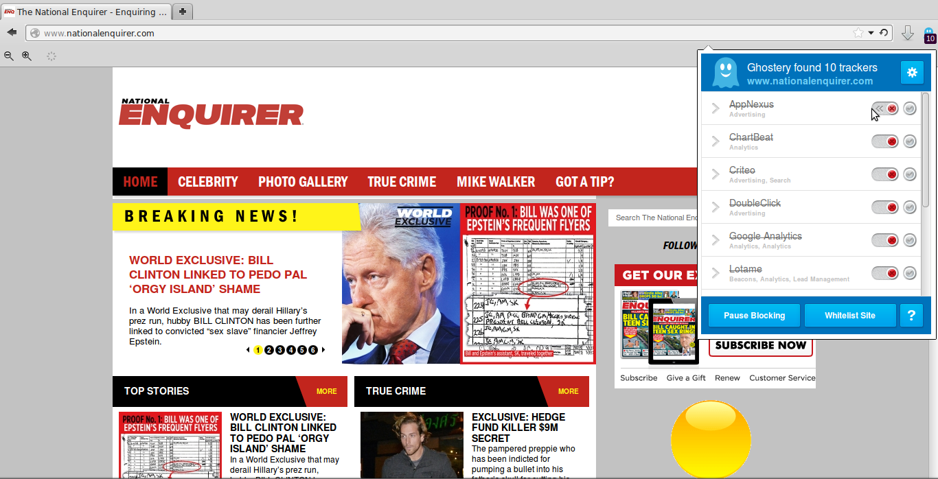

Ghostery is a add-on that blocks things that can track you. A lot of them are things like Google Analytics, which sites use to track individual users and gain information about what kinds of things they like so that ads can be targeted, and also so that information can be collected by Google. Ghostery uses a little ghost emblem in the corner that displays what's being blocked, and if I choose to, I can whitelist a site, pause or unpause blocking, or temporarily enable certain potential trackers. It's a great tool that can double as an ad blocker.
Once you've gone to the add-ons and installed it, after a restart of Firefox you'll be brought into the Ghostery welcome and setup wizard. This will allow you to choose what potential trackers to block. In my own case, I've chosen to block everything. In the fair amount of time I've been using this tool, I haven't found it to cause any issues except for the occasional disabling of a widget (but it's easy to temporarily re-enable it).

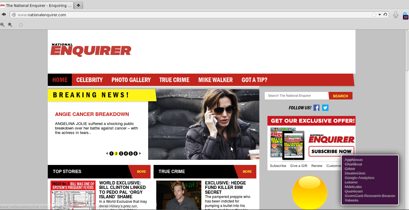

With Ghostery installed, you'll notice that if I visit a site Ghostery will notice potential trackers, notify me by bringing up the text in the lower right, and disable them. (This notification can be removed in settings, and it does go away after a choosable amount of time.)
For an example, I've chosen to visit a site that I figured might have the sort of things that could track people or get analytics, the National Enquirer. Please not that I'm not picking on this site in particular-- Trackers are often used by sites to figure out what people are looking at on a site and the like. Almost all sites will have a couple.
A close up on the trackers Ghostery found appear in the lower right. As I have told Ghostery to block everything, you can see that all the potential trackers have been crossed off, to show that they've been blocked.

By clicking on the Ghostery icon in the upper right corner, I can choose to temporarily pause blocking, whitelist this site, allow specific applications to run, or temporarily allow specific applications to run.
