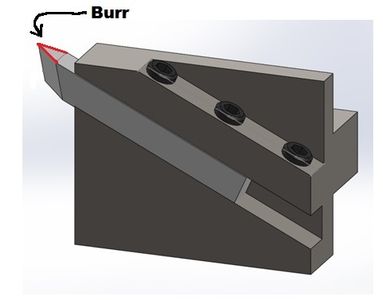

Since the wheels are made of a soft rubber (urethane) the cutting tool of choice needs to be extremely sharp, be presented on center, and have a high positive rake. This allows for the wheel rubber to be "cut" versus "smashed" as with 0 rake tools. Also since the wheel is 62mm in diameter the surface feet per minute is quite high. This is needed because at low speeds the tool could "tare" the rubber. I would suggest 150-400 rpm.
Feeds and speeds
•20 degreese positive rake,
•.002 radius
•.030-.060 depth of cut
•150-400 rpm

Step 5: UPDATE: Tool Holder
This latest idea uses a tool holder that presents the tool at 30 deg of positive rake!
Aluminum is a great material for the tool holder, use 1/4-20 set screws.
