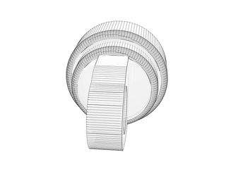

Not the smartest on my part, the car flew 20 feet before nose diving into the grass immediately ripping off the front bumper, only to send it into a violent tumble. Examining the damage I found that while the bumper had been ripped off, I could not drive it as the back left shock cap was broken. I thought about gluing it back together but its integrity was clearly breached. I didn't want to pay upwards thirty dollars for a new shock set, so I set about finding a solution.
Step 1: Step 1 3D Print
I went ahead and designed a new reinforced version in 123D Design. This program is free from Autodesk and works on PC/Mac. You will need to download the .stl file if you just want to print it as it is or the .123dx file if you would like to modify it for a vehicle other than a Traxxas.
You will need to have a 3D Printer or use a service such as Shapeways.
Print at 100% infill, no support, and ABS is preferable to PLA as it is more durable and strong.

Simply unscrew your broken shock, I used pliers to take off the cap.
Warning: Don't spill the liquids inside the shock
Simply press the new cap onto the shock, and screw it back together.
